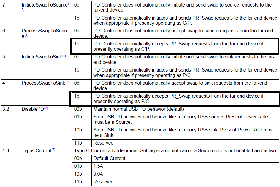

  • Hi Maurice,
    Thanks for reaching out to us.
    If you look at the register values written in both the case then the only difference is the first byte which is 0x52 when PR_Swap is and 0x02 when the PR_Swap is not working.
    Now if you look at Table 3.14 of the "TPS65987DDH and TPS65988DH Host Interface Technical Reference Manual" then you find that writing 0x52 to the first byte if this register enables the "ProcessSwapToSource" and "ProcessSwapToSink" features. This allows the PD controller to accept PR_Swap messages as the PD controller will process the incoming PR_Swap requests. However, if the highlighted bits are not set (when 0x02 is written to this register) then the PD controller doesn't automatically accept the PR_Swap requests and you see that it not working.
    Please click "This resolves my issue" if I was able to answer your question.
    Rahul
  • Hi, Rahul-san,
    Yes, of course we confirmed "ProcessSwapToSource & "ProcessSwapToSink".
    But
    (1) We understand ProcessSwapToSink & ProcessSwapToSource are bits
    that can set response of TPS65987D when receiving PR_Swap,
    But TPS65987D stop making PR_Swap itself by "Write 29 04 02 44 19 C7" command.
    Why is this?
    This is different from spec. of ProcessSwapToSource/Sink.
    (2) And also, "Write 29 04 02 44 19 C7" command is needed according to UCSI specification.
    If 4CC command "SWSr" & "SWSk" won't work by this command,
    we cannot pass logo test (HLK).
    So we think you need to revise base firmware.

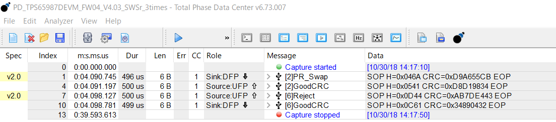

  • Hi, Atiq-san,
    We tried 4CC "SWSr" / "SWSk" command by using TPS65987D-90EVM again.
    <Validation environment>
    Attach AC adaptor & PD adaptor to TPS65987D-90EVM.
    Measure I2C & PD negotiation with analyzer.
    <Procedure> "SWSr" command
    (1) Execute "SWSr" command (Write 08 04 53 57 53 72)
    ->TPS65987D makes PR_Swap.
    (2) Write 29 04 02 44 19 C7
    -> ProcessSwapToSource becomes 0.
    (3) Execute "SWSr" command 3 times.
    -> TPS65987D won't make PR_Swap.
    #About "SWSk" & "ProcessSwapToSink", you can see the similar phenomenon.
    # And also, I sent I2C / PD negotiation log files to Yone-san & Rahul-san.
    For detail, please refer these files.
    Anyway, As I've told Yone-san before,
    In datasheet of TPS65987D, it doesn't say
    TPS65987D won't make PR_Swap by 4CC command "SWSr" & "SWSk" by ProcessSwapToSink/Source=0.
    These bits determine whether TPS65987D accepts PR_Swap or not,
    and they don't determine whether TPS65987D makes PR_Swap or not.
    In other words, TPS65987D works wrong with specification datasheet.
    After all, base firmware must be revised as the countermeasure
    so that TPS65987D makes PR_Swap even if ProcessSwapToSource / Sink = 0.
    Thank you.

  • Hi, Rahul-san,
    Thank you for your reply.
    >It's an expected behaviour because say to start with 87D was in sink role
    >and you issue the UCSI command then the 87D will go to Source role.
    >Now, second time onwards the 87D is already in Source mode
    No.
    First time 87D makes PR_Swap by "SWSr" command, but far-end device rejected.
    So 87D is still Sink when we command "SWSr" again.
    Please confirm attached files.
    And also, we think it's strange
    87D won't make PR_Swap gain, whether 87D is Source or Sink.
    Thank you.
    For detail, please confirm the attached log file.
    Why PR_Swap won't be made?

  • Hi Maurice,
    I got the I2C and PD logs from Satoshi San and after reviewing this we found that this is an expected behaviour.
    Explanation:
    Our PD controller issues a PR Swap after getting the SET_PDR UCSI command and this PR Swap command is rejected from the port partner (other device connected to the laptop). Upon receiving this Rejection our PD controller knows that the port partner doesn't support PR Swap feature and therefore doesn't sent PR Swap command even when SET_PDR UCSI command is received as the PD controller knows that the port partner doesn't support PR swap.
    Please let us know what is your expectation when SET_PDR command is issued 2nd time onwards.
    Rahul
