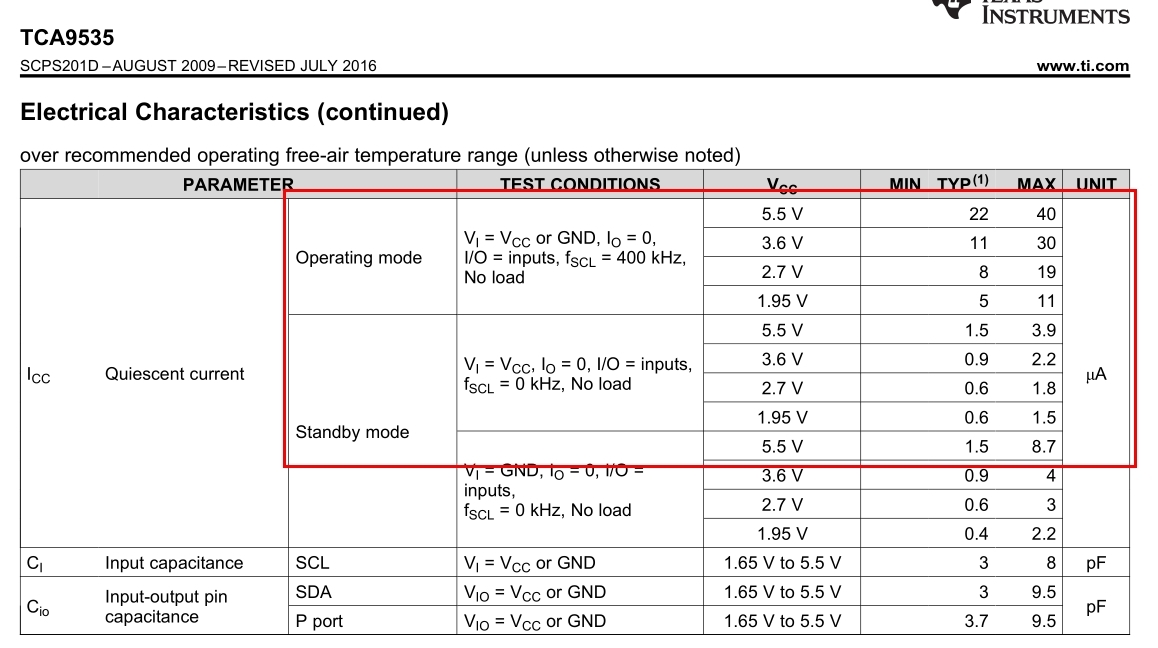

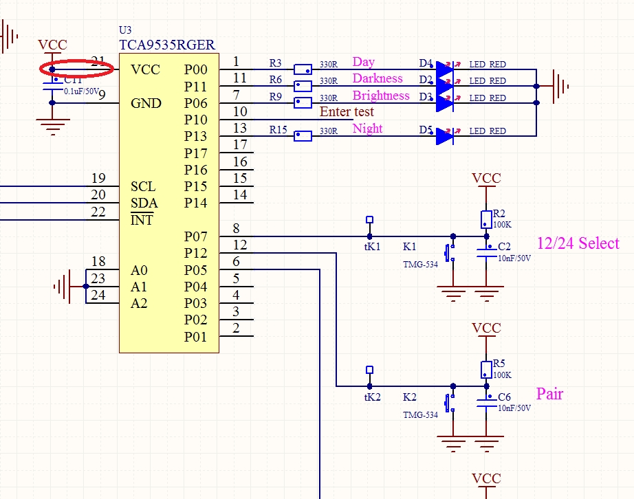

     The following table is the Iq parameters of TCA9535, please help to check three questions:
1,If I/O set to input, and the I/O pin float, whether I/O pin going to be unstable?
2,If I/O set to output, is the Iq unstable? Because my client test a few boards when I/O is output, and I/O all float, the Iq is all different, the minimum is 3uA, the biggest is 50uA, the TCA9535 has no CLK.
3. If I/O set to input, and I/O connect LED to GND, is there still current from I/O to LED?

    "3. If I/O set to input, and I/O connect LED to GND, is there still current from I/O to LED?"
    You are saying the pin connected to the LED will be an input? Likely in this case the LED will be turned off unless noise (from PCB or EMI) coupled onto the pin. It would be best to set the pin to an output low to make sure the LED stays off.
    Technically there will be current from I/O to the LED due to leakage but not enough to turn on the LED in most cases. When the device is set as an input, the pin is considered high impedance.
    -Bobby
  • Dear Bobby:
    Thanks!
    My customer want to into standby mode, because the Iq is only 3.9uA(MAX), but the condition is I/O set to input.
    You said: "The supply current will be lowest when the device is set to an output. If the pins are floating inputs then the supply current could change as the floating pins drift in voltage."
    So when is the current minimum? Customer want into a lowest Iq status.

  • Hi Bobby,
    Could you pls check the condition(input or output, floating or non-floating) to achieve lowest Iq?
    Since according to datasheet shown above, we found the standby mode would be achieved when I/O is set to input.
    Thank you.
  • Hello Leo,
    Sorry I didn't see the messages here until just now.
    "Could you pls check the condition(input or output, floating or non-floating) to achieve lowest Iq?"
    Looking at the datasheet, the best Iq is when the device is referenced to Vcc. (Do not leave them floating). If you set the device to an output high you will reference the inputs to be seeing a logic high. Alternatively you could also just tie a pull up resistor to Vcc and leave the device an input. My thought on this is it is better to set the device as an input and supply Vcc through a large pull up resistor. (As an output high, the Ron would be low compared to an external pull up resulting in more current consumption which is why I believe using an external reference is better than using the output as reference).
    -Bobby
