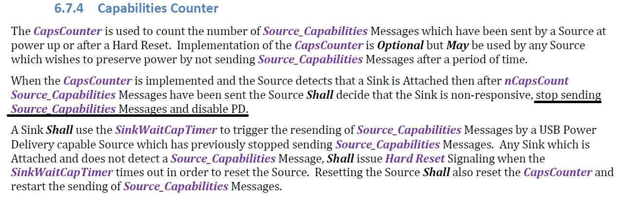

My customer is using TPS65987D as a power source and found that TPS65987D will keep sending the source capability message for 9 seconds and stops if there is no response on sink side. I know this behavior is compliant with PD spec, but due to customer's sink device will need 18 second to boot and response to the PD command, so it will handshake failed.
And on the other hand, it will work fine with another PD adaptor, because this PD adaptor keep sending the source capability messages.
I saw the PD spec have a statement on section 6.6.6, "For a non-responsive device, the Policy Engine in a Source May either decide to continue sending Source_Capabilities Messages or to go to non-USB Power Delivery operation and cease sending Source_Capabilities Messages."
So I would like to ask your help to change our PD FW behavior and make it keep sending the source capability for a non-responsive device, I believe this will help to make TPS65987D more compatible.
Or if you could add this on configuration tool, that will also helps. Due to customer could not keep verify their platform without PD, we need your quick response to help us secure this socket.
