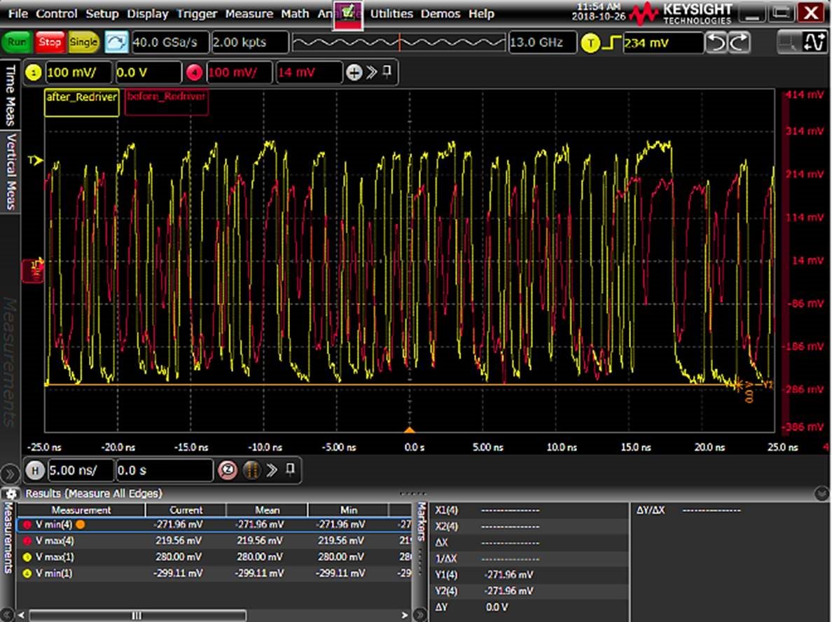

We have use DP130 on edp signal, there have three items fail on eye pattern test.
Actually we'll use software send pattern on edp test, we sure the Swing, Pre-emphasis setting have into the re-driver when our software send pattern, but the Swing, Pre-emphasis setting will be fixed when passed the re-driver so we couldn't change any setting.
Could you help us to share experienct how to fix it?
Schematic as below
Our setting are default.

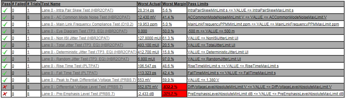

    Would you please share the failing report? What pattern did you send and did you change the DP130 SWING and Pre-emphasis setting?
    David

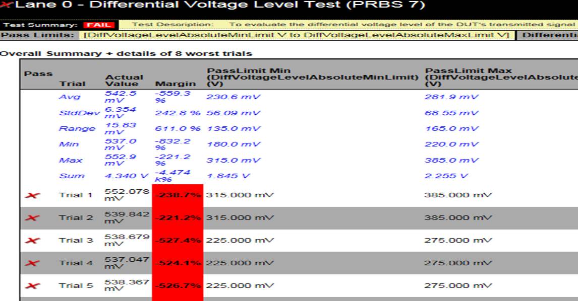

  • Hi David,
    Sorry for missed fail report
    Please refer as below
  • Shu-Cheng
    Are you disabling link training in DP130 and manually set the equalizer, output VOD, and pre-emphasis level?

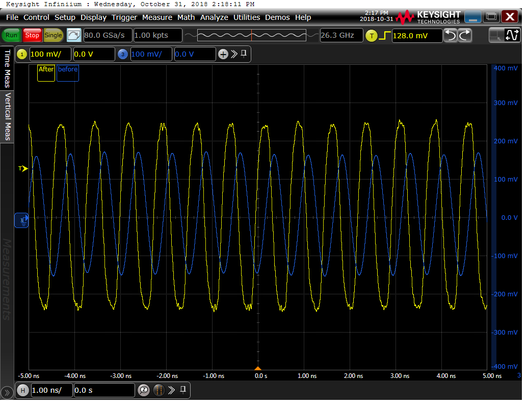

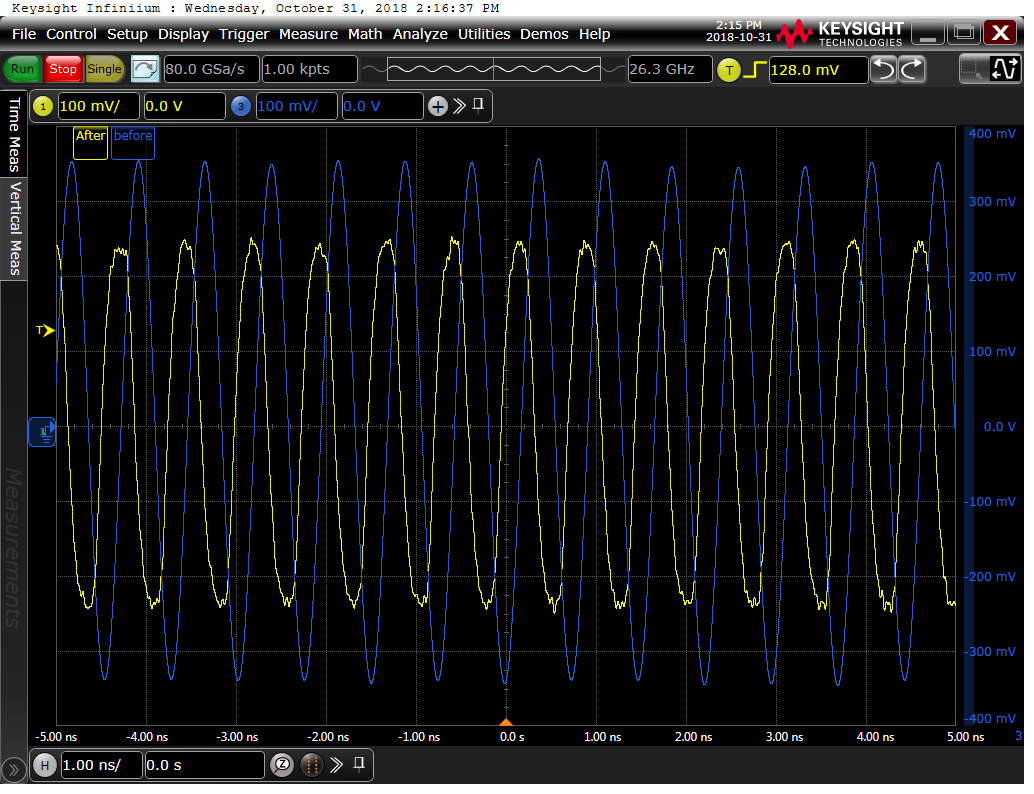

    We have try to pull high 3.3 v on DP_ADDR_EQ, we found input Voltage Swing and Pre Emphasis could change but the output always fixed, please refer as below
    We think our schematic is ok ( you have checked before)
    Our software is use ”DisplayPortApplet_v4.27_x64”
    Thanks!!

    3. Why our DP130 output always be fixed around 250mV whether the input is 350mv or 180mv?

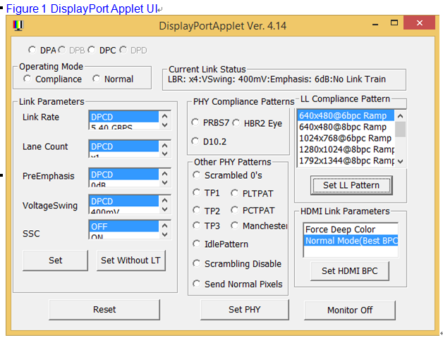

    4. Our test GUI as below, could you help check which setting is suitable for us?
  • Shu-Cheng
    In a typical DP application, DP130 output would connect to a DP connector and the DP cable length will change. But in a typical eDP application, DP130 output is permanently connected to the eDP panel, so the trace length between the DP130 and eDP is fixed and will not change.
    Knowing the trace length is fixed, then it is possible that the link training can be disabled through I2C control and DP130 EQ, Pre-emphasis, and VOD can be manually set base on the fixed trace length. Link training is enabled by default, but can be disabled using I2C.
    DP130 has its own TX VOD (amplitude) and pre-emphasis level. The amplitude being set by the GPU will not be sent by DP130. DP130 will send the signal with its own TX VOD and pre-emphasis. This is why I am asking to disable the link training, and manually set the DP130 VOD and pre-emphasis and see if a particular setting will pass the eDP compliance test.
