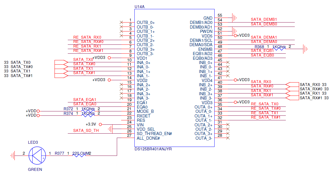

We're using the DS125BR401A re-driver for SATA interface as picture below.
We'd like to confirm the placement location.
Case1.
PCH -> DS125BR401A trace length 2.2"
DS125BR401A -> Connector trace length 9.6"
Case2.
PCH -> DS125BR401A trace length 10"
DS125BR401A -> Connector trace length 2.4"
Could you please help to provide placement suggestion to us?
Thank you.
  • I would recommend to use the DS125BR401A farther away from the PCH (10" option).
    I would also recommend to give an option to program the DS125BR401A with the SMBus.  This allows for more control over the signal conditioning functions.
    Lee
  • Hi Carlos,
    My colleague - Lee - may have additional comment but here is some recommendation:
    Case 1: DS125BR401A has linear receivers on INA side. Therefor link training would go through DS125BR401 INA to OUTA. INA should be used when there is a short trace to the transmitter.
    PCH -> 2.2" Trace length -> DS125BR401A (INA_0 through INA_3) -> DS125BR401A(OUTA_0 through OUTA_3) driving 9.6" trace length
    Case 2: DS125BR401 INB limiting side is more tuned for longer trace length. Therefor in this case, we can do the followings:
    PCH -> 10" Trace length -> DS125BR401A(INB_0 through INB_3) -> DS125BR401A(OUTB_0 through OUTB_3) driving 2.4" trace length
    Also, the recommendation is to start off with low equalization and no de-emphases - allowing heavy lifting equalization to be done by the receiving side. You can increase amount of equalization if needed.
    Regards,,nasser
