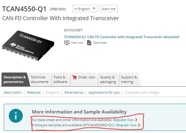

  • Betty,
    The TCAN4550 has not yet been released to market, but it is currently sampling on TI.com, and its full datasheet can be requested via links provided in the product folder.  See the snapshot below:
