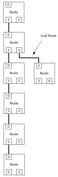

Good day,
We experience random bus resets, the moment you connect a "leave" node to a network of 30 nodes configured for 1394b ports. A "leave" node is explained below:
The moment you configure the link connected to the leave node to be a 1394A port, the resets disappear. Reading the ERRATA LLZ015C the BOSS arbitration was also solved with this resolution. This make us think this problem are also related to the BOSS arbitration.
Do you have any evidence that this problem was solved with TSB81BA3E silicon or might it still be present? Any suggestion or work around you can suggest?

    We have also confirmed on our side, the moment all 3 ports are active on the same PHY for a period of at least 12 hours, you are guaranteed to get bus resets. If you disable or loop disable any one of the ports on that same PHY, so that only 2 are active at a time, the bus resets totally disappear for 48 hour runs and longer. The moment you change the third port to 1394A, all bus resets also disappear. Any possible explanation what might be the cause of this, possibly still a timeout problem in a state machine of the PHY? According to us, the only solution is to have only 2 ports active on the same PHY at all times?

  • Hello Johan, this Richard Mourn with FlightWire Technology, I would like to understand the characteristic of the bus reset. Do you see a bus reset, nodes disappear for ~550 milli-seconds and re-appear? If so, this maybe noise/load issue causing a loss of synchronization. I've seen this issue on a poorly laid out board that worked fine with two ports connected but would periodically (one or two hours) have bus resets (disconnect) when three ports were connected.

    That is correct, we do see a sequence of bus resets directly after each other and then the bus fully recovers again between 530 and 590ms later. Please give more information on what was wrong on the layouts (cross talk, impedance mismatch, differential track length mismatch, reference planes?). Can we please get a confirmation that a re-spin of these PCB's, solved the above reset problem? Was it again tested for more than 12 hour runs, because that is typical the time we need to run the whole system before we experience the reset.
    We have 3 different form factor LRU's with different layouts in the system (in total 30 nodes on the bus). All 3 give exactly the same results. You can have any 2 ports active continuously for more than 48 hours with no resets at all. Switching the active connections to the other ports on the same PHY's and run 48 hour tests with still no resets. This test gave us good confidence that the integrity of all 3 ports of the 30 PHY's are good and stable. We even introduced 30 meter commercial cables between ports to really push the links to there limits and got no resets.
    The moment we make all 3 ports active of any one of the 30 PHY's, we get the above reset within 12 hour runs. You need to do more than 12 hours runs to be guaranteed of a reset.

    I believe this issue is tied to the de-scrambler in the PHY losing synchronization with the incoming signal. This causes the PHY to misinterpret the incoming scrambled 8B10B symbols which in turn cause the bus resets  to happened. If a PHY receives four or more tightly spaced bus resets, it will disconnect and then go through the connection process (~550msec). This is good because the connection must be retrained to re-sync the de-scrambler to the incoming signal again.
    We know this problem exists but unfortunately we don't know the exact root cause. It appears to be a noise related issue but the exact root cause of how the de-scrambler gets corrupted hasn't been determined.
