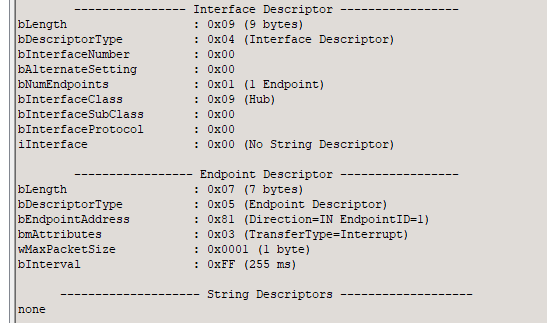

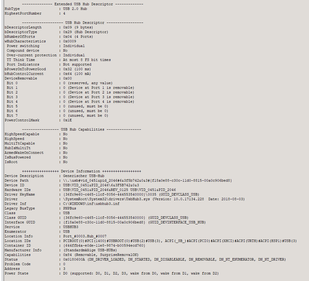

    The device show USB 1.1 on Windows (like in the picture ) is it correct ??? because the other Hub was showing usb 2.0

  • The TUSB2046B is a full speed hub (USB 1.1), so it is correct for it to report that in the descriptors.
    Do the downstream ports work in Windows?

  • Do the downstream ports work in Windows?
    yes all downstream ports work correctly in windows.
