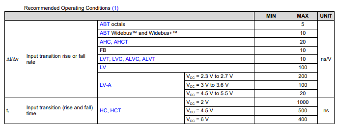

Hello Hao-san.
Thank you for your support.
I have found the following application notes.
http://www.tij.co.jp/jp/lit/an/scba004d/scba004d.pdf
The slow input value for CMOS & BiCMOS is specified for P3.
If SN75C1168 has no provision for slow input,
Based on the value of 5 μs to 10 μs, should I design in less time?
Best Regars.
Fukazawa
Fukazawa-san,
Thanks for the information. I understand your concern now. My two cents why it's not an issue: 1) SN75C1168 has 2 channels. Therefore if the throughput current happened, it would not generate the heat problem as bad as a 10 bit or 16 bit device; 2) SN75C1168 works with Mbps data rate, which means rise/fall time of the input data can be around 10s of ns that is far from the slow input region.
Please let me know if you have more questions.
Hao
