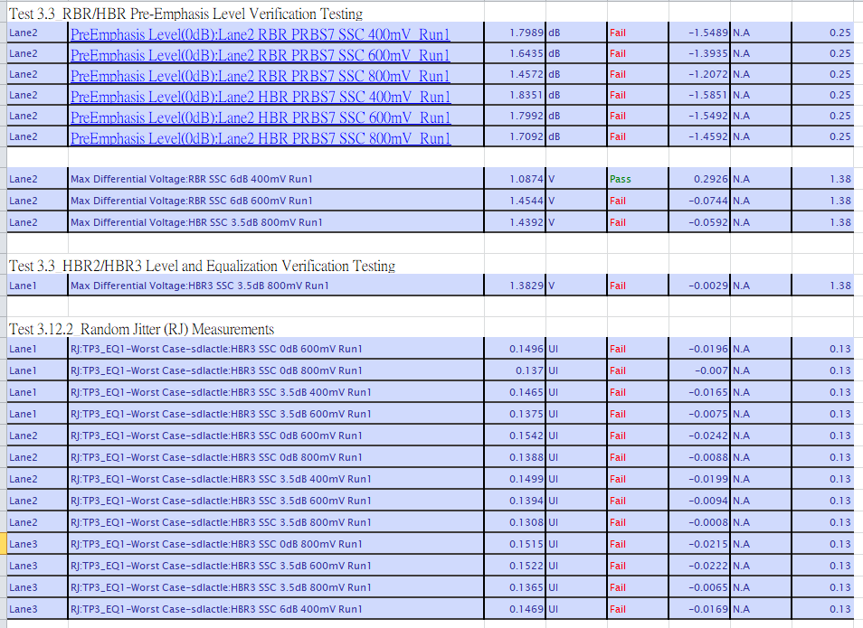

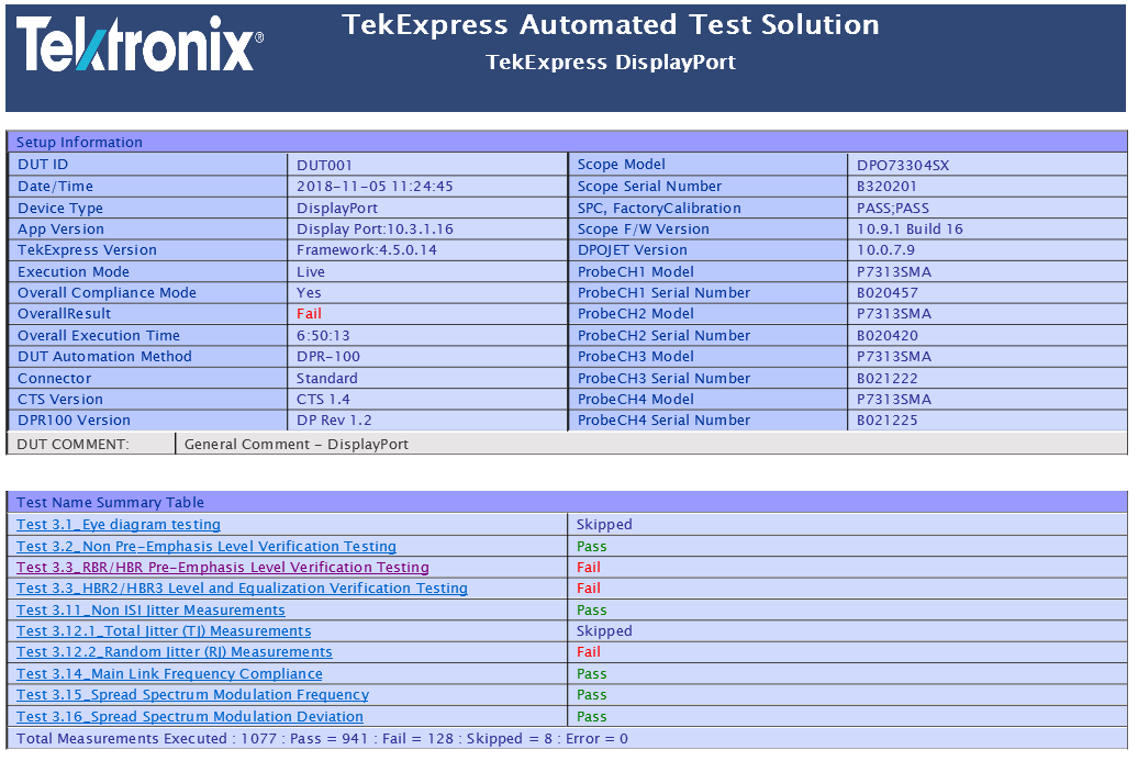

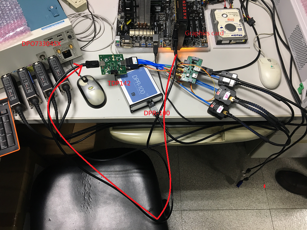

Our customer use the Tektronix DPO73304SX & DPR-100 want to verify TDP142 performance,
if Series TDP142EVM in system, then can't test, remove TDP142EVM can test DisplayPoart and Pass.
System is Graphics card--> TDP142-->Test Tool--> monitor
is this TDP142EVM junm setting issue? or how to verify?
