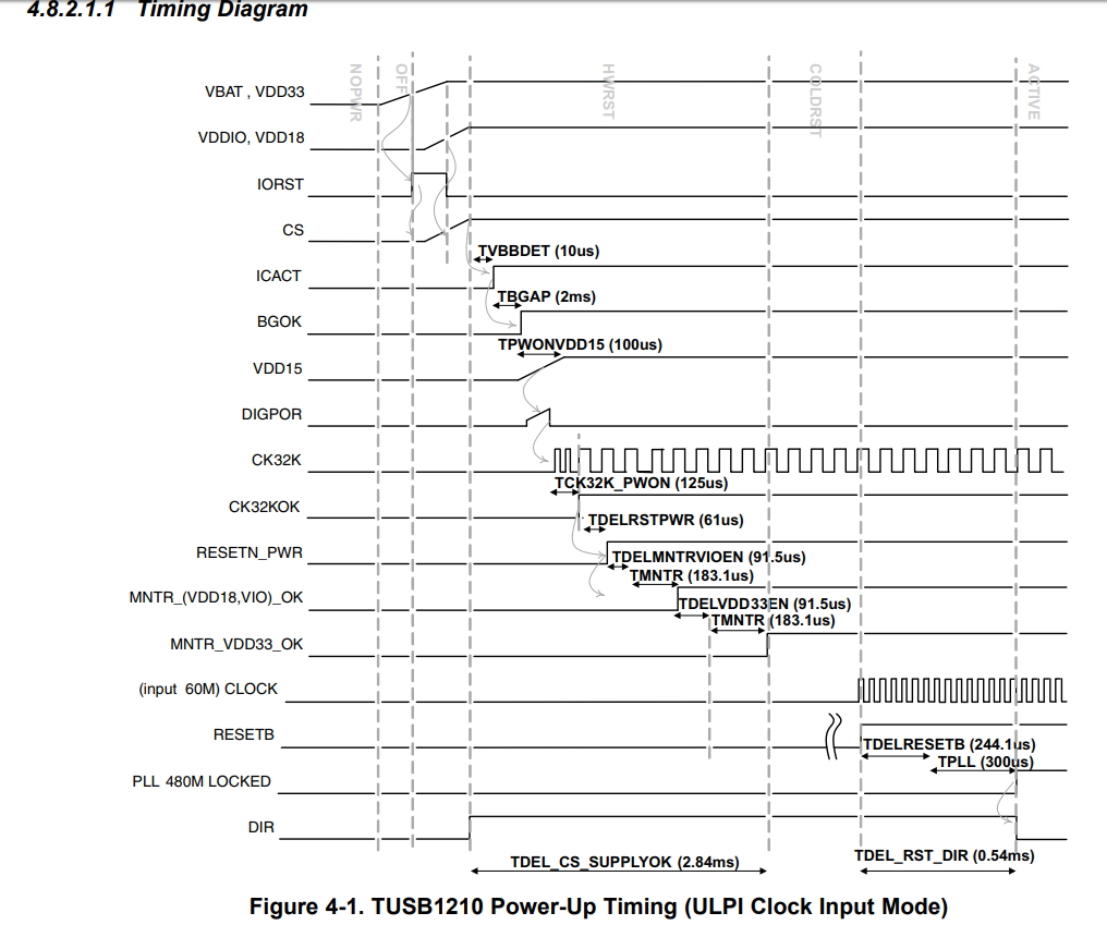

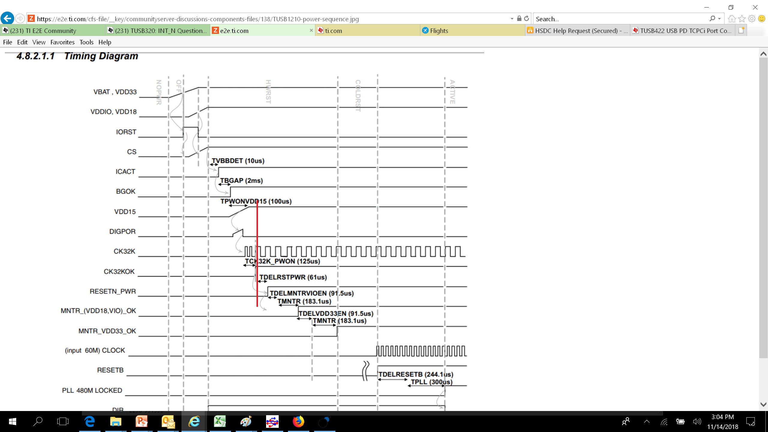

TUSB1210 initial fail.pptxHi Team
             We have usd TI TUSB1210 on system board.
We have fine Vbus(5V) and 3.3 turn on togeter ==> TUSB1210 function is ok
if 5V turn on before DC_3V3 ==> TUSB1210 function will be fail
Have any power sequence for 3.3V and 5V ?
The file is TUSB1210 circuit and TUSB1210 initial fail waveform.
