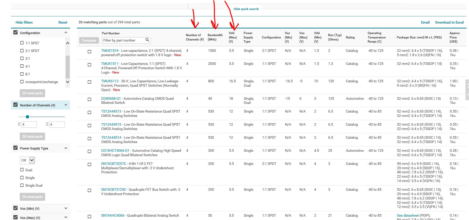

Patrick,
You may use the ti.com switch selection tool to find 4-channel devices with 5V supply that have 30MHz bandwidth. Using these 3 filters there are 26 devices that meet your requirements.
To narrow it down further we will need to know what type of signals do you need to switch? What package you would like?
What do you think about the new TMUX1574?
