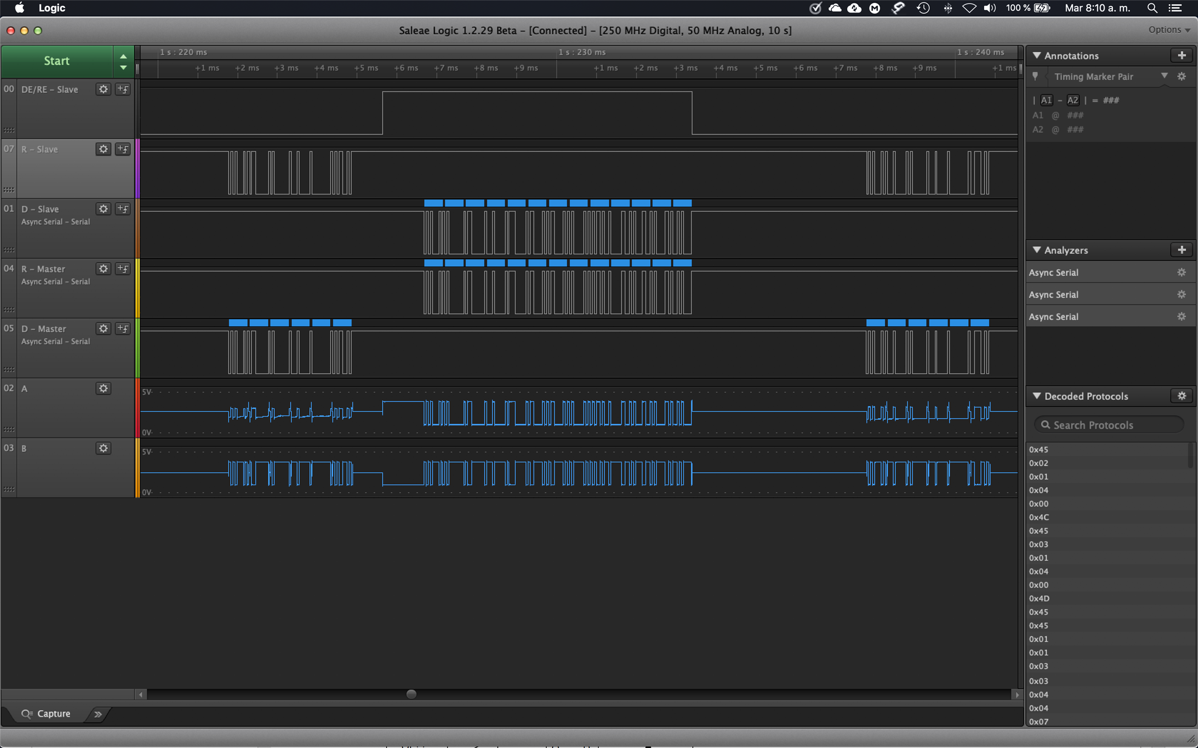

- I'm connecting together Pin 2 & 3 (DE,RE). If Pin 2 & 3 are Low (RX mode) pin 4 (TX line) is idle (high level) and I want to transmit, when Pin 2 & 3 go high on output lines A B a HIGH - LOW - HIGH pulse appears while Pin 4 remains High.
This transition is interpreted as an erroneous start condition by receivers.
Do you know why this pulse is produced and how to solve it?

  •  Hello Max,
    Thanks for your fast response,
    Yesterday I changed some PSU capacitors and now I can't see the mentioned pulse any more, but I guess the problem is with SN75176 master,
    please look attached waveform.
    Master device's pulses shape is not good but these are received well by slave devices.
    Best Regards.
  • Derwys,
    I'm glad to hear the system is functional, although the "A" signal coming from the master side seems degraded (typically it would be the mirror image of the "B" waveform). Are there any components (series resistances, pull-up/pull-down resistances, filter capacitors, clamping diodes, etc.) on the A line that are not present on B? Or, does a new unit installed on the master side show the same behavior?
    Max
  • Max,
    On master side there is only a failsafe/load resistor network, VCC-600 ohm-130 ohm-600 ohm-GROUND.
    It would be the same load for both A / B lines, and the same load for slave devices.
    I'm looking for a new 75176 for replace it on master side.
