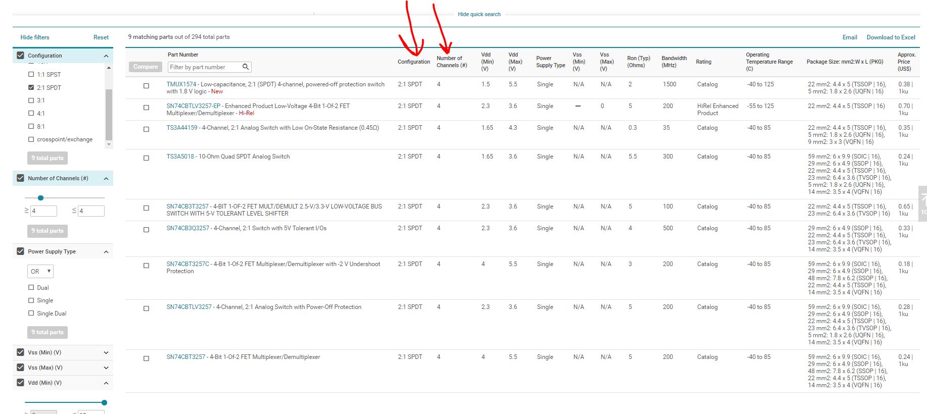

My customer is looking for DPDT analog switch device that is matched with MAX4699. Would you help suggest what we should promote? THanks.

TI calls MAX4699 switch configuration 2:1, 4-channel. Using the ti.com switch search tool you can filter for 2:1, 4-channel devices. There are 9 different devices to choose from including the new TMUX1574 and the p2p QFN TS3A44159.
To help narrow the selection down further we would need to know what signals the customer is needing to switch voltage, bandwidth, etc. and what supply rails they have available.

Thank you for your answers. I think sn74cbt3257c is a good fit.
