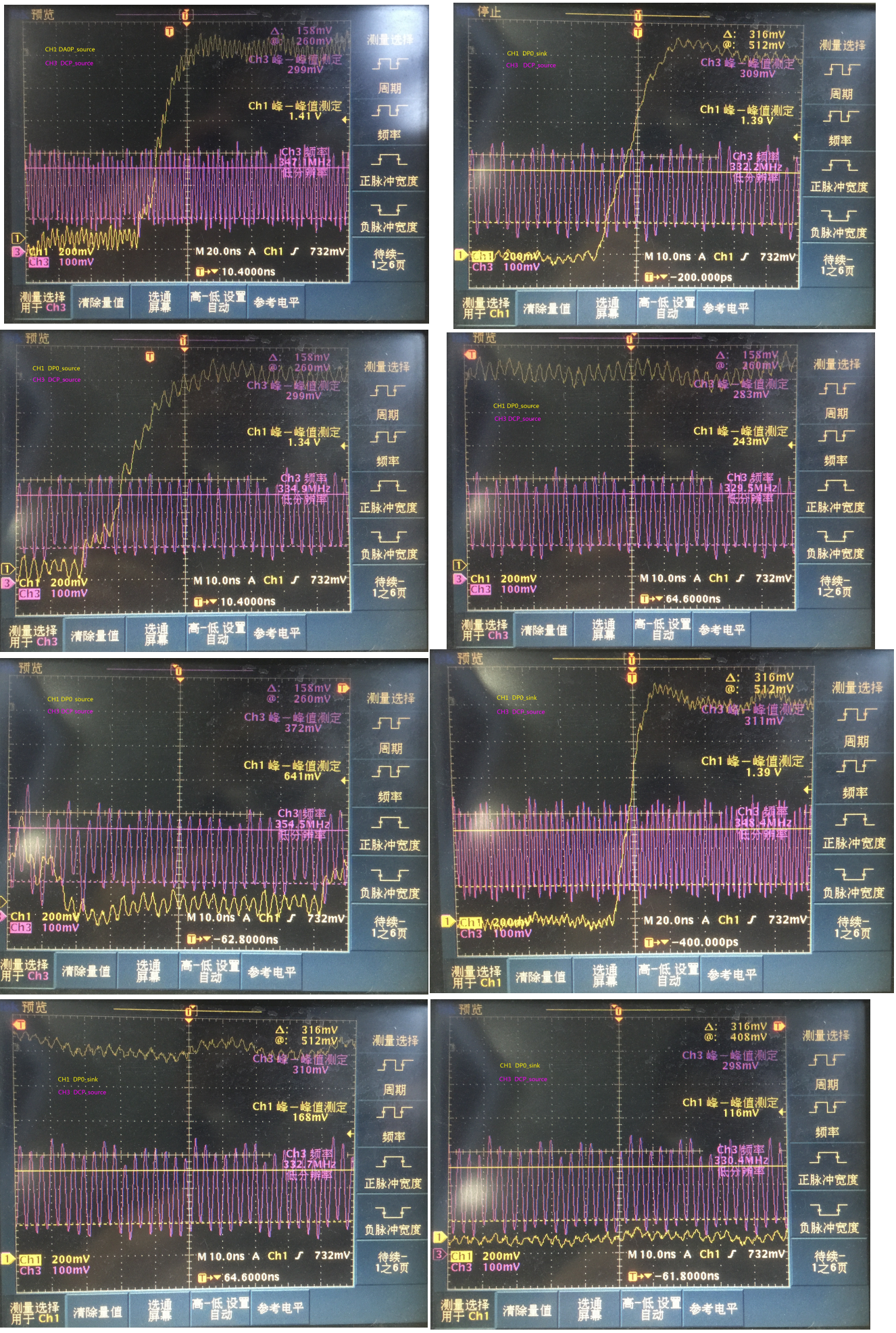

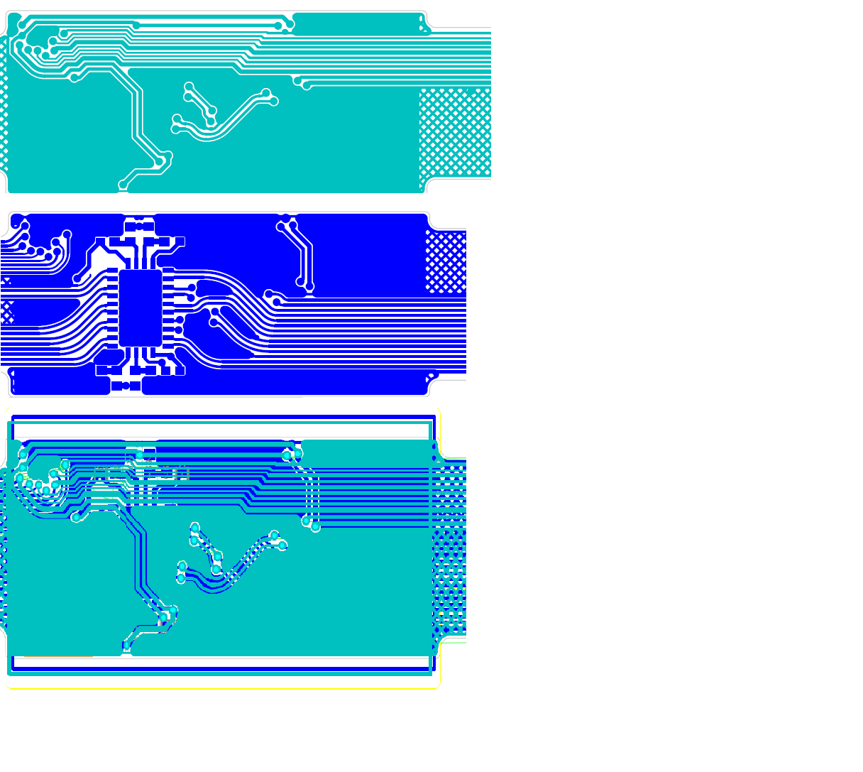

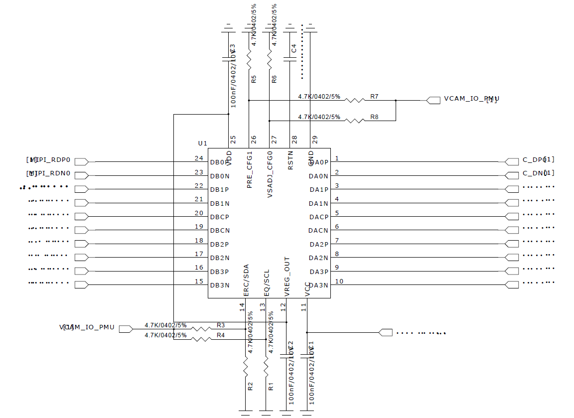

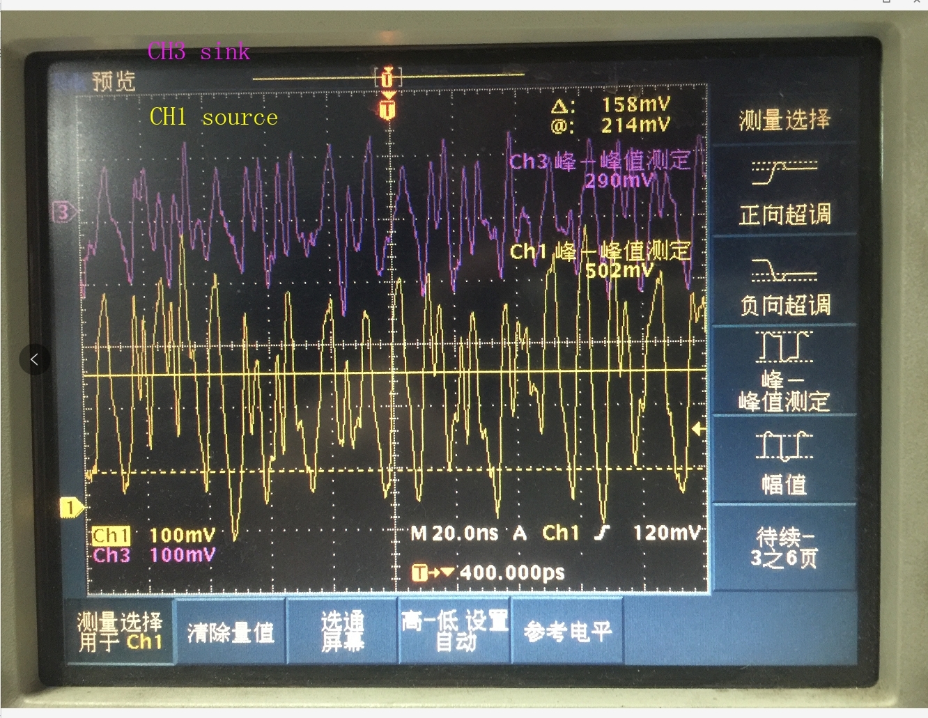

Camera FPC is 34cm long, so SN75DPHY440SS is used. We have made the following configuration combination debugging. After entering the camera, there are black screens and no images.
Because there are too many combinations, do you have any suggestions or recommendations?
Thank you
Jerry
Explain
M stands for the pin to be pulled up and down by 75K resistor.
L stands for the pin to be pulled down to ground by 75K resistance.
H stands for the pin to be pulled to the 1.8V power by 75K resistor.
VSADJ_CFG0=L:    VIL = 200 mV or 220 mV based on PRE_CFG1 sampled state;
VSADJ_CFG0=M:  VIM = 200 mV typical;
VSADJ_CFG0=H:   VIH=220mV typical;
PRE_CFG1=L:        VIL=0dB:
PRE_CFG1=M:      VIM=0dB;
PRE_CFG1=H:       VIH=2.5dB;
EQ/SCL=L:            VIL=0dB;
EQ/SCL=M:          VIM=2.5dB;
EQ/SCL=H:           VIH=5dB;
ERC/SDA=L:         VIL=200ps;
ERC/SDA=M:       VIM=150ps;
ERC/SDA=H:        VIH=250ps:
VSADJ_CFG0
PRE_CFG1
EQ/SCL
ERC/SDA
phenomenon
L
M
M
M
Black screen
M
M
M
M
Black screen
M
L
M
M
Black screen
M
M
H
M
Black screen
M
M
H
H
Black screen
