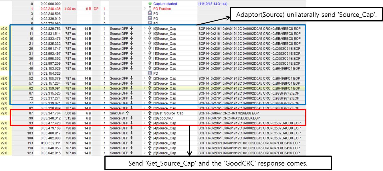

    I have additional questions.
    With an EVM, everything is solved.
    But the EVM seems to have been discontinued. Is that right?
  • yes,it's discontinued, but how you get EVM?
  • I'm sorry. I wrote it wrong. I don't have an EVM.
    It is now successful to send a message.
    1. Do not send GoodCRC automatically.
    2. Adaptor(Source) unilaterally send 'Source_Cap'.
    Which register should I check?
  • Is PD Rx enabled for SOP?
  • Hello, Brian
    0x2F is enabled for 0x01(SOP Enable).
    If you can provide us with a sample code, please send it here.

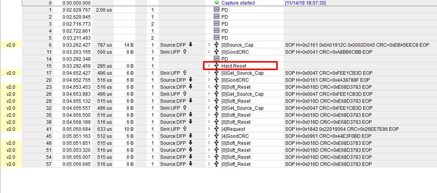

    Then, the power supply is "hard reset" as shown below.
    The data read for each register are as follows.
    Please help me.

  • In addition, sending 'Get_Source_Cap' only comes with 'GoodCRC'message.
    The Source Cap message does not come.
