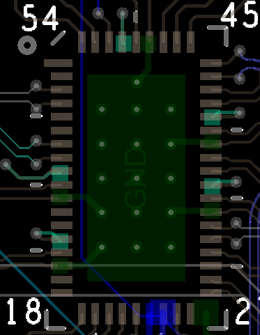

  • Hi Sir,
    Could you please support check the Layout?
    Hugo
  • Hi Lee,
    May I have your help to review the layout?
    Thank you.
    T2352-IDXTM-8004_GF-PCIEconn_V0_9-181122_pm6.zip
  • Hi Hugo,
    Are you designing for 85 ohm impedance?
    Are the AC coupling capacitors 0402 size?
    Lee
  • Hi Lee,
    The Thunderbolt 3 Spec is 90ohm, so our customer is 90ohm impedance.
    The AC coupling is 0402 size.
    Hugo
  • Hi Hugo,
    90 Ohm impedance and 0402 size capacitors are a good combination.
    I would rework the thermal pad vias into a more symmetrical arrangement to improve manufacturing.  Here is an example, you can cut down on the size of the VDD_2.5V moat, there is not a big need to connect the pins externally.
    Lee
