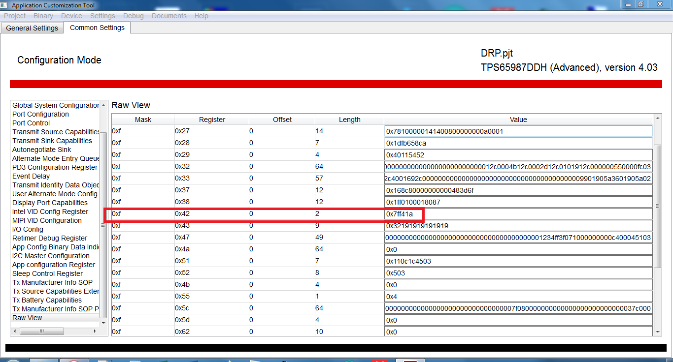

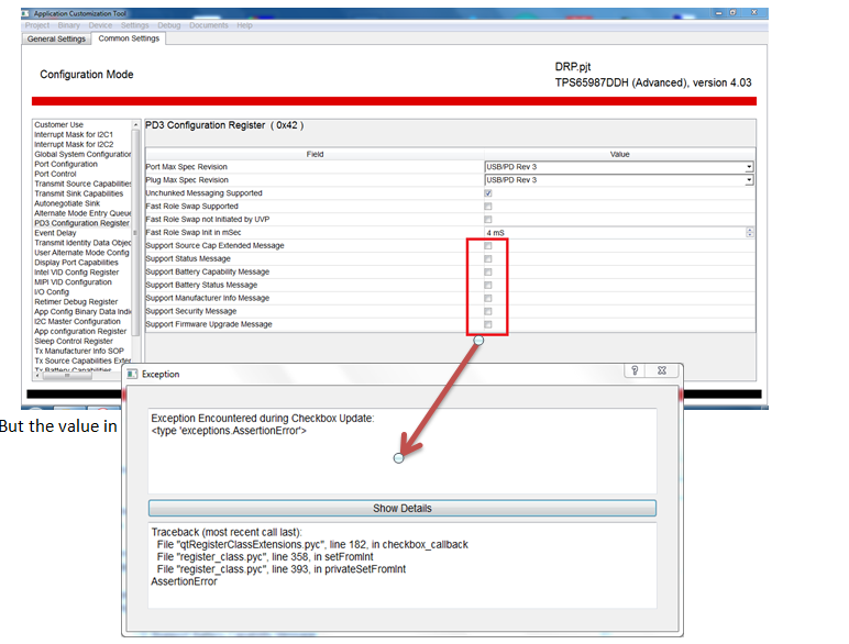

The following failure message appears :
But the value in register 0x42 is good!?
Does the SOP is fully operating on the evaluation board and software?

    SOP is used by the Type-C PD specification. They can communicate from one side of the Type-C cable to the other side using an Alternate Mode. You could follow the following app note which describes how to implement this:
