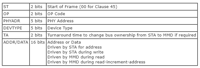

    • Ensure that you are following the MDIO frame format is as follows:
      • ST /OP / PHYADDR / DEVTYPE / TA / (ADDR/DATA)  16BITS
