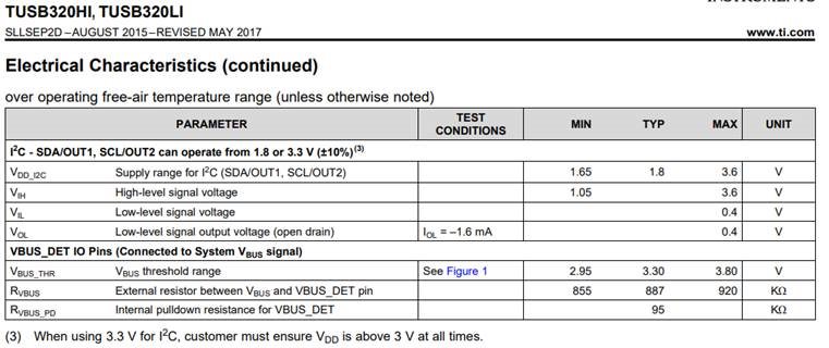

There is a question about INT_N open drain functionality at TUSB320LI from my customer.
At I2C operation description(7.2.4) , it´s mentiond, that the pin is in open drain configuration an needs an additional pull up, at reference schematic of UFP I2C mode operation(8.2.3) the pin is pulled up to VDD which is different as I2C (1V8 or3V3) at reference circuit… and aslo a note, that INT_N sould have a pull up to VDD…
For my understanding, this makes no sense in this usecase.
Can Please check the behavior of the INT_N pin in UFP I2Cconfiguration internally to help to clarify…
