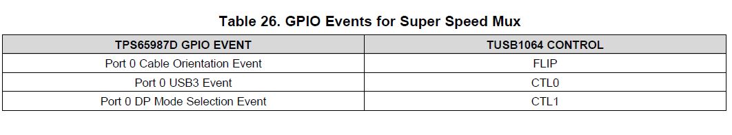

We have a cusomter using TPS65987D +TUSB1046(Source side) and TPS65987D+TUSB1064(Sink side). and currenlty the source side work ok(setting volagte output 5V,12V correct and USB3.0/DP work fine with USB3.0 decve and DP input moniter). And then they connect source and sink side together, we can see the voltage output correct(5V, 12V) and also have USB2.0 singal. However, we can't dedect the USB3.0 and DP singal though TUSB1064. Currenlty , we set the TUSB1064 GPIO(FLIP,CLT0,CLT1) pin as below(according to TPS65987D spec). Could you kinldy adivse us what might cause this issue? we attach the schemaitc and the Sink side TPS65987D configuration file  as your reference

    It is easier to debug in TUSB1064 I2C mode than in GPIO mode. But if you are using GPIO mode, manually tie CTL0 high, CTL1 low, and FLIP either high or low depends on the cable orientation. You can do the same in I2C mode by writing to register 0x0Ah. This will bypass the PD controller and focus only on TUSB1064.

    Sorry to bother you again. we are able to make customer's TPS65987D works with the DP 2 lane +USB3.0 mode. However,when RD is testing DP 4 lanes function,  it seems  the TPS65987D GPIO(control CTL0,CTL1,FLIP pin) wouldn't control TUSB1064 into the 4 lanes DP mode.the connection and configure setting are follow the spec suggestion shown as below. Could you kindly give us some suggestion for this issue?thanks in advance

    Would you please check to see if multi-function bit in the PD controller is enabled? If multi-function is enabled, then PD controller will configure TUSB1064 as 2 lane DP + USB. Please disable multi-function bit first.

    The multi function bit is set in the Display Port configuration register.
