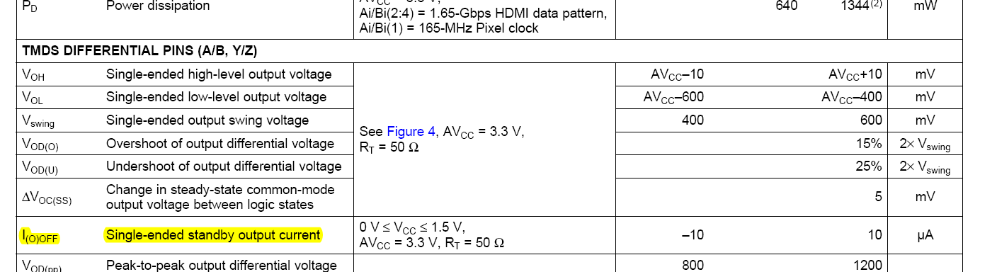

    As far as back feeding, the TMDS442 has a spec of less than 10 uA of leakage (Ioff) from the TMDS signals.  Where are you seeing the leakage?
