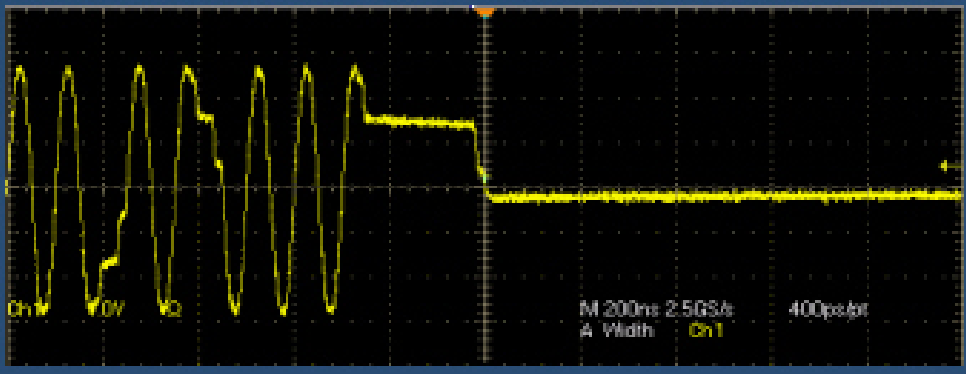

    We would like to know 10Base Harmonics test at Complaince test.
    If we get these following wave form, could you let us know the register setting?
    We assume that it requires to set follows;

  • Hi Matsumoto-san,
    The TP_IDLE_00 signal will only appear once and it will be the idle symbol preceded by a 00.
    Your script would look like this:
    begin
    001F 8000 //software reset (clears register)
    0000 0100 //programs DUT to 10BASE-Te mode
    0019 0021 //programs DUT to Forced MDI mode, set to 4021 for MDIX mode
    0027 0013 //programs DUT to generate 10base-te repetitive 1 output.
    001F 4000 //digital reset (doesn’t clear register)
    After that,
    0027 001a //programs DUT to generate TP_IDLE_00
    end
    The DUT will only create the pulse once each time you write register 0x0027.

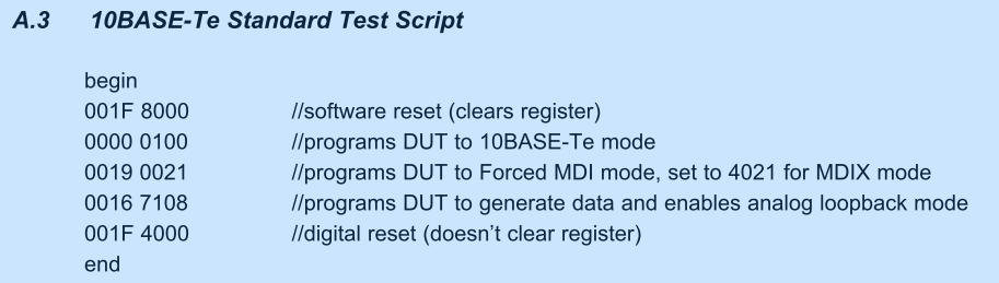

    If you want the data packet to be continuous, use this script:
    begin
    0016 7101 //programs DUT to digital loopback and generates 10base-te random data
    end
