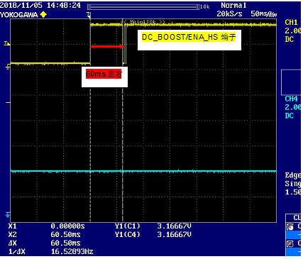

Dear Sir
when my customer use TUSB212-Q1, they find there is two drop pulse in the pin of ENA_HS after 60ms when it is become to high, I want to know is there any reason will cause this drop pulse happen?--Thank you

Dear Brian
Thank you
DC and AC boost is setting by resistors. DC boost is setting as 22Kohm to GND, no resistor to VCC.AC boost is 0ohm to GND.
it is always happen.
