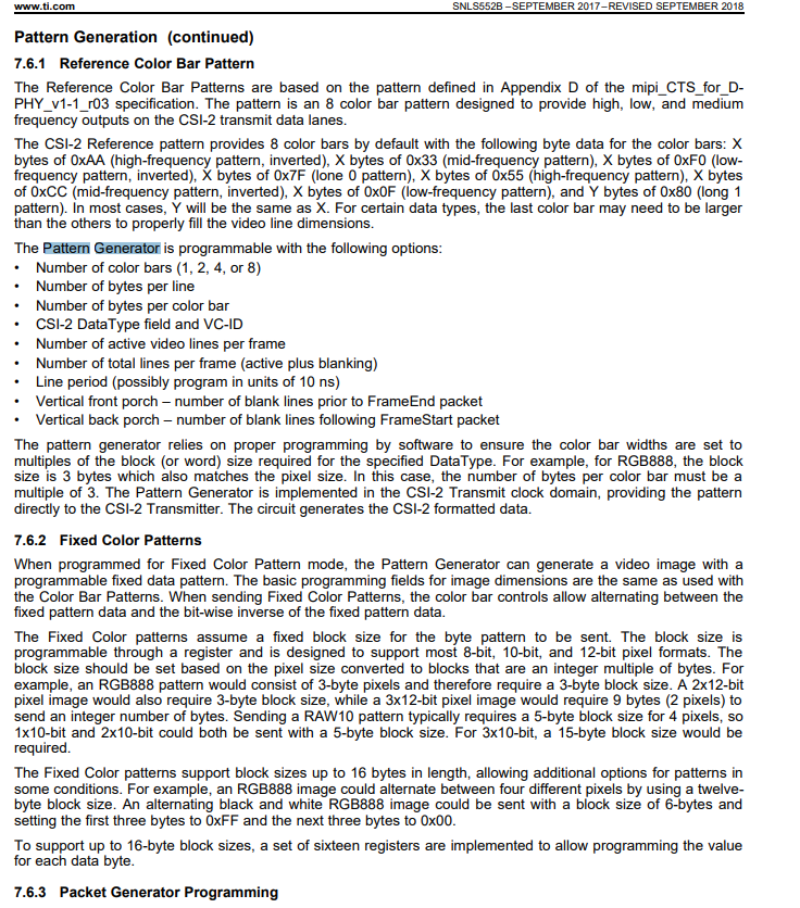

We have a system with FPD III camera I/F using the DS90UB960-Q1 deserializer.
We want to be able to test our system with high resolution "known" test videos.
We thought of using this EVB board as a bridge feeding it from FPGA or FTDI.
1. Does serializer is compatible with the DS90UB960-Q1 deserializer?
2. Did someone have a different idea / solution to test FPD deseralizer with known input driven from SW?
