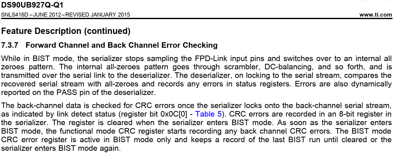

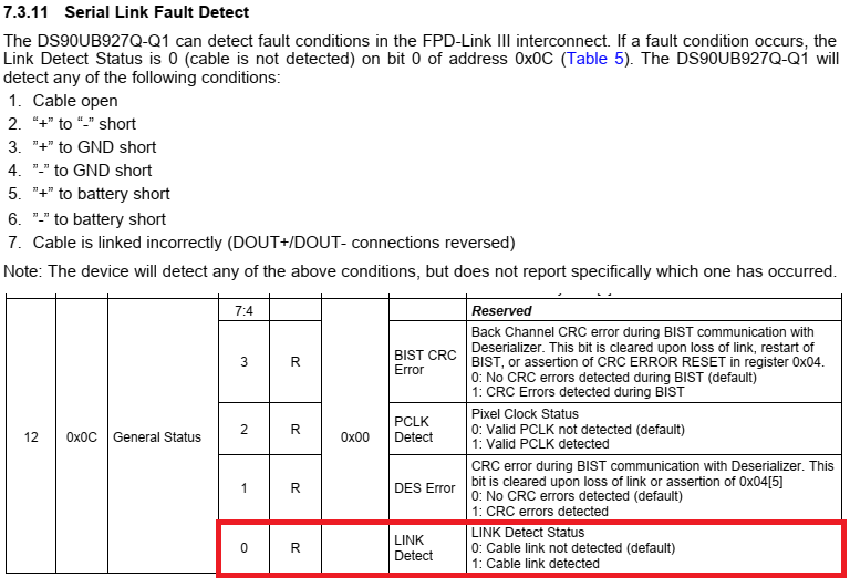

Can you please let me know the detail condition where DS90UB927-Q1 detects the link fault?
Does DS90UB927-Q1 monitor the voltage at DOUT+/- pins and compare with reference voltage?
Or detect based on the CRC error on the backchannel communication?
