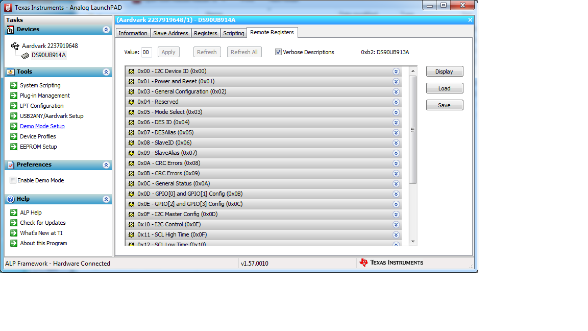

We try using the TI utility Analog LaunchPad to do the same thing, still no response from 913.
Below is the screenshot of how it looks for us when using the utility

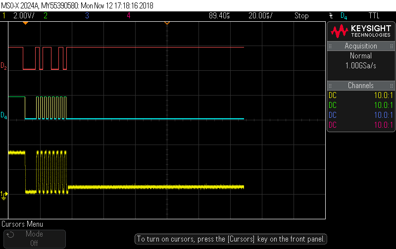

We have the waveforms of the scope probing at the i2c SDA (red plot) and SCL (blue digital version, yellow analog version) of the 914 below.  It shows when we try to talk to device 0x59, the i2c clock is being stretched, and we don't get acknowledge bit.  The link then goes to timeout.

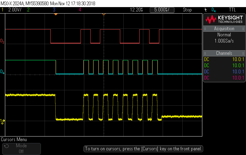

Zooming in of the same plot below
