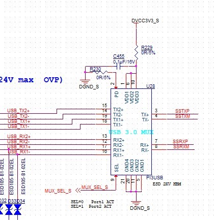

I will use TPS65987D and Type C Connector connect to a USB 3.0 Signal switch , it's PI33USB302.
CC1 &CC2 signal will be connected to TPS65987D  PIN#24 &#26,
Does there have any signal will output from TPS65987D to tel the Type C Connector  is CC1 side plug in ? or CC2 side plug in?

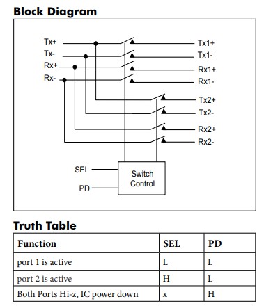

I don't know how to connect the CC1/CC2 signal output  from  TPS65987D to   PI33USB302 Switch ( Pin#9)  to determine  Type c input signal side.
Could you give me some advice?
