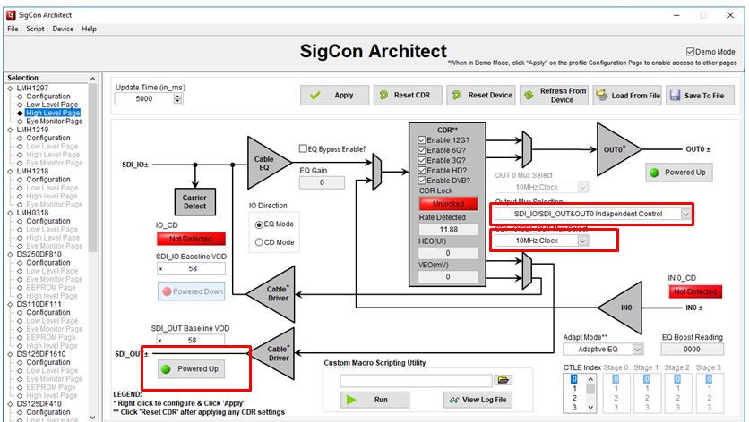

  • Hello.
    Thank you for your reply.
     I have an additional question.
    We will use the LMH1297 and LMH0397 in EQ mode.
    How should we set when measuring the return loss of SDI_OUT (loop-through)?
    Thank you.
  •  Greetings Ishii-San,
    You can enable 10-MHz clock on SDI_OUT either through AigconArchitect GUI or through register settings. Please note attached graph. Also, please refer to the LMH1297/LMH0397 programming guide.
    Regards,,Nasser
