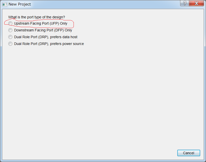

    2. I download GUI tool. Could you please let me know the setting procedure for TIDA-01627? Should I select "Upstream Facing Port?

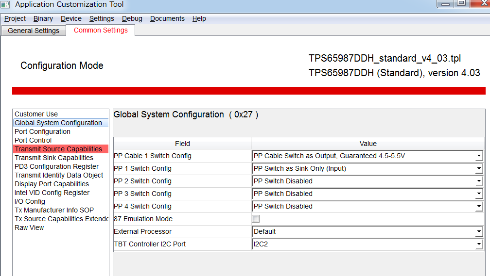

    3. The latest customization tool is different from the picture in document "Using I2C master in TPS65988 PD controller".
    How should I set I2C master configuration with below screen?

    2. I would recommend selecting DRP prefers Power Source for a power bank design.
    3. You need to select an "Advanced" template in order to reveal the I2C master options. In your image, you had selected a standard template.

    If the TPS65987D is going to be the I2C master for the BQ25703A, then all I2C writes must be configured in the Application Customization Tool and loaded onto the TPS65987D from the SPI Flash during boot up. The I2C master writes in the TPS65987D cannot be changed during run-time.
