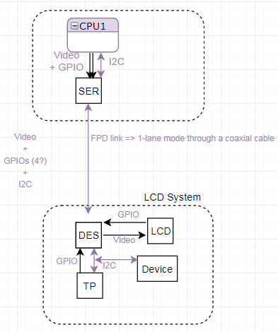

My customer intend to use our DS90UB948/9 Ser-Des solutions, as shown in the bloc diagram below:
- could you confirm that it's possible to connect multiple devices on the I2C bus (behind the Deserializer)?
- what is the effective I2C bandwidth regarding the whole serial interface?
- could you confirm that the following configuration is supported with a 1-lane interface using a coaxial cable, knowing that it should support video of 1280x800, with a pclk=71.1MHz (60fps)?
  • Hi TISL,
    -Are TP and Device in your diagram masters or slaves? If they are masters, you need to make sure the two masters can arbitrate between themselves, or you can consider using an I2C switch. If they are slaves, then it should be fine, just make sure you have the right pull-up resistors.
    -I'm not sure what exactly you are asking, but we support I2C with 1Mbps fast-mode plus
    -With a 948/949 system, the FPD-Link operates at up to 3.36Gbps line rate in 1-lane mode. Your display should work.

  • Hi Jiashow,
    - TP and Devices are slaves, in fact. CPU1 is the Master. So it's fine, right?
    - Regarding the line rate in 1-lane mode. I can't find any collateral that would help to understand how to compute the needed speed of our application. Is it just limited by the PCLK? Could you show us any formula or way to confirm the application viability? Is there any restriction using a coax cable?
  • 1. yes, it can support. you can refer to the app. note " ", generally FPD-Link can support up to 8 remote slave I2C device.
    www.ti.com/.../litabsmultiplefilelist.tsp
    2. it has no bandwidth concept here. it is dependent on the I2C speed which is listed in FPD-Link d/s, such as fast I2C speed 400Kbps.

    I'm still confused on the 1-lane capabilities.
    Your first comment was:
    My question here, is not related to the I²C, but to the Serdes capabilities, to support the 1280x800 video:
    -I can't find any collateral that would help to understand how to compute the needed speed of our application. Is it just limited by the PCLK? Could you show us any formula or way to confirm the application viability? Is there any restriction using a coax cable?
  • got it.
    FPD-Link is one serdes, the core is line rate. its application is for video transmission, so pixel clock freq. is used to assess the FPD-Link capability. in general, the video is defined by pixel clock, calculated by 1280x800x frame rate (not mentioned by you) x ~1.1blanking. if the frame rate (typ.) is 60fps, the pixel clock is ~70MHz which is less than maximum pixel clock 96MHz for UB94x single lane application.
