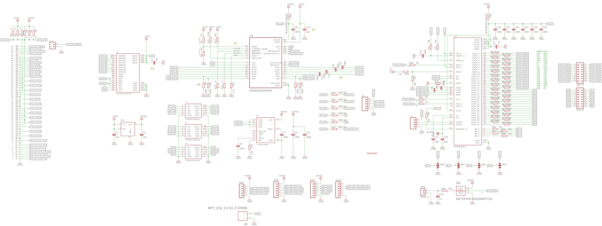

I'm attempting to connect an FT601 by FTDI to the computer through a usb type-c cable. For what I could understand from the datasheet, I needed to configure the HD3SS3220 in UFP mode. The thing is that the DIR pin is always high. The cable orientation is never detected and by measuring the resistance of the SS lines I figured that the mux never actually switches.

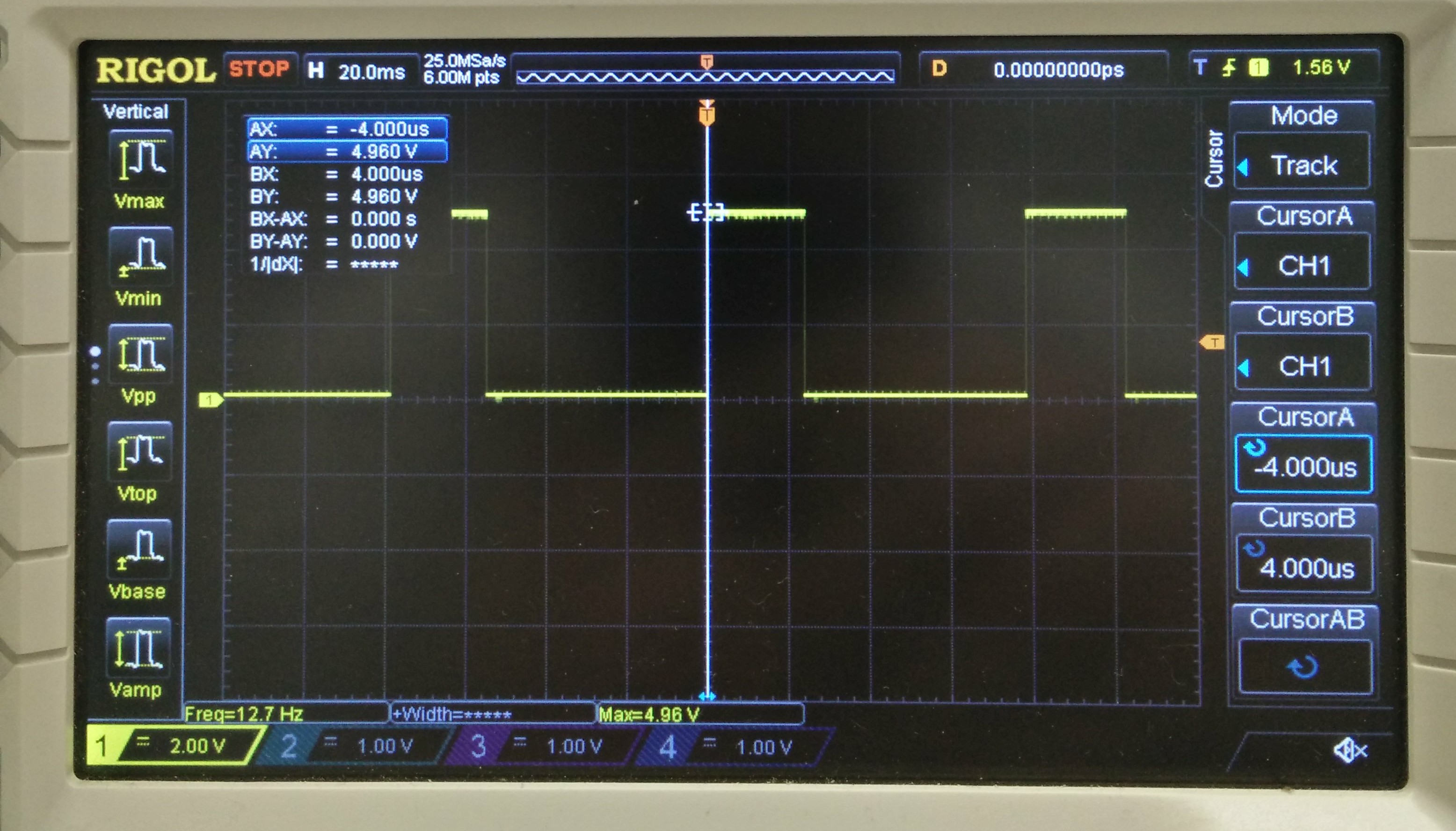

I'm using a USB Type-C to USB 3.0 Type-A cable with a 56k pullup. The CC lines show 418 mV and 0 V in one orientation but when I flip the cable they show a square wave with 4.8V peak and around 13Hz frequency.

    According to the datasheets those pins you mentioned are all open-drain so the voltage to which we pull-up to depends on the interface of the controlling system. At the moment the device is configured in GPIO mode. I'm not actually using those signals but made provisioning for it in case I needed to. The only reason I installed some of those resistors was to try to figure out why the HD3SS3220 wasn't working.

    C4 and C5 are not needed, would you please replace them with 0 ohm resistors?

    Replacing C4 and C5 with 0 ohm resistors shows the same behaviour
  • Do you have the 200k resistor installed on DIR?
    David
  • At the moment I have all the resistors installed apart from R7, R8 and R12

  • [CC1, CC2, DIR] are respectively [426 mV, 15 mV, 3.29 V] for normal orientation and ["square wave", "square wave", 3.29 V] flipped.
    This is what I mean by "square wave"

    In the flip orientation, it looks like CC2 is not seeing the pullup resistor on the host side.

    And you were absolutely right about the CC2 not seeing the pullup resistor. Turns out that the Type-C receptacle we are using (DX07S024XJ1R1100) has smd pads for A1 to A12 and through pins from B1 to B12. During our initial debugging, we detected that there were some issues with the soldering of the through pins. Evidently we didn't fix all of them. CC2 was indeed disconnected. After applying flux and soldering again the HD3SS3220 came to life in both orientations.
