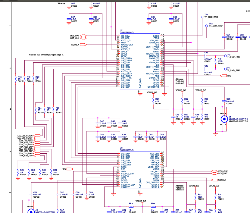

Hi All,
We have a sensor+ 953 Serialiser(with i2c Addr 0x18) +954 Deserialiser( 2 Lane output) combination working on a TDA2P custom board.
We have a connection from the Deserialiser 954 to another DS90UB953 serialiser where replicated output from Deser is sent to Serialiser( with i2c addr 0x19)
Can anyone please confirm how to verify that CSI2 data is being received by the serialiser( with addr 0x19).
Attaching a part of schematics
