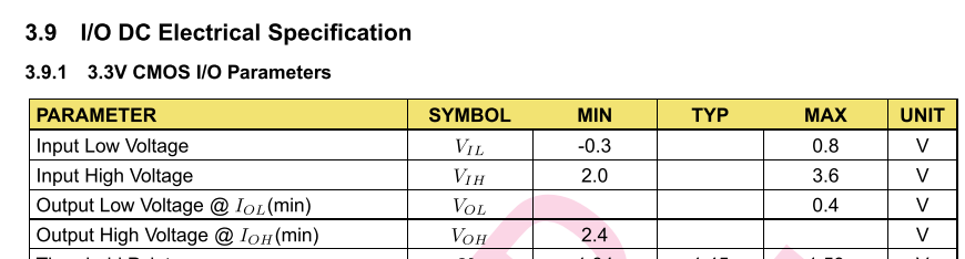

VCCA=V3V3_AUX
VCCB=V3V3
IOL condition for port B connection : under 0.4V is the requirement
Attachment  is MUX LTC4306 spec for PORT B connection.
https://www.analog.com/media/en/technical-documentation/data-sheets/4306.pdf
Below is the spec for port A connection…….under 0.8V is the requirement

    I'm not quite sure what you mean by IoL condition and state a voltage. IoL is measured in A (or milliamps). Are you saying you need something that generates a VoL of 0.4V or less when IoL is 3mA? <-- this is I2C standard.
    "Below is the spec for port A connection…….under 0.8V is the requirement  "
    You need ViL to be 0.8V? To me it sounds like you just need VoL to be less than 0.8V not ViL.

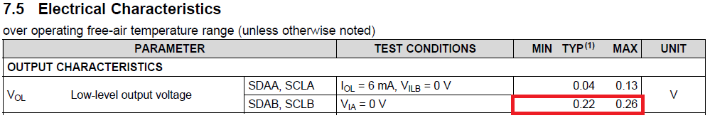

    Are you trying to do a P2P replacement without doing layout changes? From how you specify an A side and a B side, it leads me to think you can't redesign the layout. TCA9517 does not meet the 0.4V requirement on B side because of it's static voltage offset.
    The only device we have that does is TCA980x. It's ViL is 30%*Vcc but it does have a "ViLc" requirement.

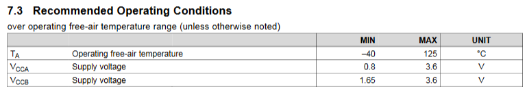

    1. The VCCA and VCCB will both be 3.3V, is there any concern on it?
    2. I2C master on A port VIL max will be 0.8V and slave on B port VIL will be 0.4V, and I see TCA980x datasheet mention that VOL is 0.22,
    is it suitable to meet both A port & B port requirement? is there any concern on it?

    "1. The VCCA and VCCB will both be 3.3V, is there any concern on it?"
    This device's recommended operating Vcc is rated for up to 3.6V on VccA and VccB .
    I don't see an issue, this device can have VccA=VccB
    "2. I2C master on A port VIL max will be 0.8V and slave on B port VIL will be 0.4V, and I see TCA980x datasheet mention that VOL is 0.22"
    As you pointed out VoLA is about 0.04V which is lower than 0.8V and VoLB is 0.22V which is less than 0.4V.
    "is it suitable to meet both A port & B port requirement?"
    VoL of our device is less than ViL of the master and slave, I don't see the concern.
    "is there any concern on it?"
    My only two concerns about using this device is the I2C master/slave on B side must have RiLc of less than 150 ohms and B side must not have any pull up resistors or be tied to an I2C switch/buffer on the static offset side.
