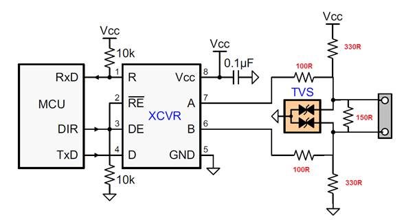

Hi Team,
I got a question from my customer if it is okay to implement the SN65HVD72 using the below diagram with the additional resistors and Vcc?
Thanks!

    This may still work, but having 100-Ohm series resistances in conjunction with 150-Ohm termination will attenuate the RS-485 signaling significantly (by more than 70%, assuming dual termination is used). This would limit the cable lengths that could be supported, since there is no budget for additional loss through the cable. Generally it would be better to keep the series resistances less than 10-20 Ohms for a terminated bus.
    What are you trying to accomplish with this resistor network?

  • Hi Max,
    Thanks for the feedback! This is the feedback I got from customer:
    The series resistor is for surge/lightning protection. The rest of the network resistor is end customer implementation, not sure why it’s done that way.
    So if we change the series resistor to 10R, you don’t see any potential problem anymore?

  • Hi Alfred,
    Sorry for the delay, last week was a holiday in the US.
    It's true that a series resistance can be effective in improving the surge/lighting immunity of a system by limiting the current that could flow into the transceiver when an over-voltage condition exists. Reducing the series resistance to 10 Ohms would mean reduced immunity, although it may still meet the overall application requirements. What surge specification is targeted for this design?
    If reducing the series resistance results in inadequate surge immunity, then there are a few different options that could be evaluated. One would be to keep the circuit as-is with the higher resistance values and evaluate the signal integrity to make sure it is sufficient even for worst-case cables. Another would be to remove the termination resistances or increase their value so that there is less attenuation across the series resistances. A third strategy would be to implement a more complex transient protection scheme (e.g., transient voltage suppression diode, metal oxide varistor, gas discharge tube, etc.). A fourth would be to use a transceiver with higher transient immunity.

  • Hi Max,
    Thanks for the feedback! Really appreciate it! Customer said they will implement 10R series resistor and qualify actual unit, they will adjust value on need basis depending on test result.
    Regarding pull up and pull down, I assume there is no concern even though not included in IC application note.
    Can you help confirm that this assumption is correct?

  • Alfred,
    Yes, the pull-up and pull-down resistances are OK to include and are useful for establishing a valid differential "high" level when all of the drivers on the bus are disabled. This technique is often referred to as failsafe biasing, and if you are interested you can read more about it here:
