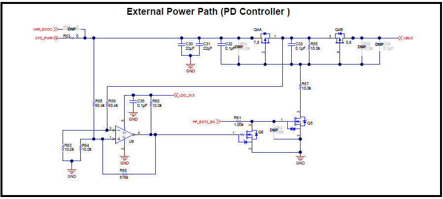

I'm designing a device which gets power DC15V 3A, using the TPS65987D, from a USB-C charger. Sink only, no USB data.
I tested successfully the wanted function with TPS65987-90EVM, which has a special block; external power path.
Can I eliminate the external power path block in my circuit?
