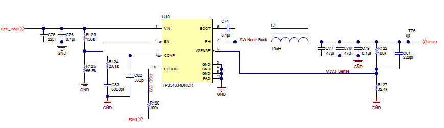

The TPS65987-90EVM uses the BUCK converter TPS54334DRCR to get 3.3V from the SYS_PWR.
In my circuit, can I use other BUCK? For example, TPS54202H?
Hi Jeong,
You could use any 3.3V Buck that meets the recommended operating conditions of the TPS65987D that are highlighted in section 6.3 of the datasheet.
