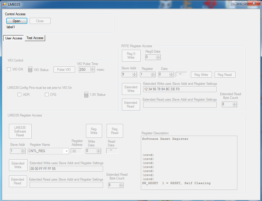

  • Hey Stanley,
    Can you provide screenshots of what you mean?
    I was able to extract the zipped file and able to open the GUI:
    Are you saying you can't get to this window or are you saying that there is an error after this window?
    -Bobby

  • Hey Stan,
    Lucky enough I had the same problem when I installed and tried to run the EVM earlier today after reading your post. I was able to find the location of the program and run it through the windows search.
    Can you click the windows button at the bottom left hand side of your screen and search "GUI"? (It should say in italic's search programs and files)
    You should see a program called '551600850A_GUI'
    If you click that you should be able to pull up the GUI window. From there you could also right click it and find the location of the file and then make a copy of it onto your desktop if needed.
    Let me know if you are able to find it this way and get it to run.
    -Bobby
