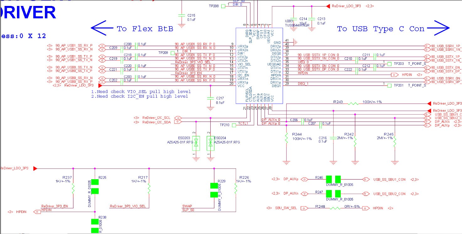

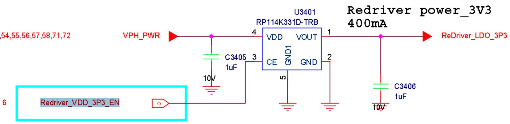

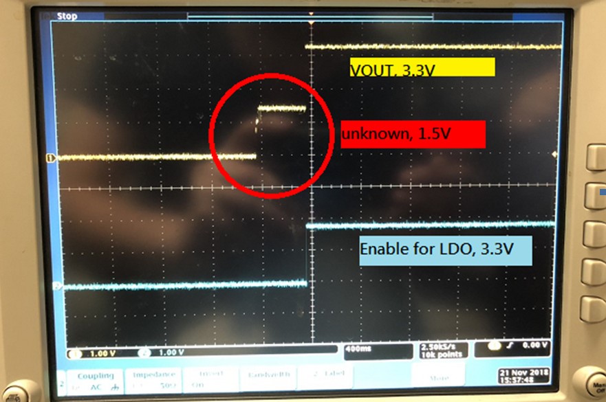

Hi Team,
We face an issue that VCC would leakage 1.5V as cable and monitor plug in, it cause I2C can not communicate.
Attached fail waveform(yellow-VCC, blue-LDO enable), and sch, please kindly help.
