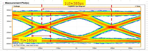

My customer asked us about Eye-Pattern measurement  of DS90UB929-Q1.

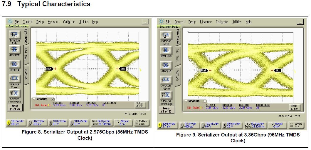

Please inform me more details of measurement condition and measurement method of Eye Pattern at Typical Characteristics of datasheet.

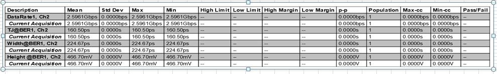

They say that Total Jtter will be over 0.3 UI no matter how many times it is measured on the EVM.
(FPlLink III: 2.6 Gbps)
In particular, please explain the details of the connection diagram on page 14 and how to measure the input signal and output waveform.
