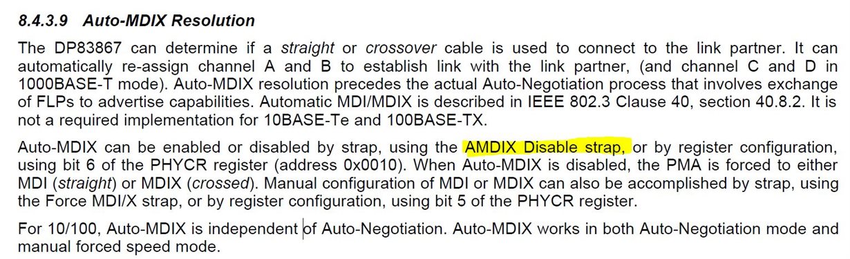

On page 30-31 (section 8.4.3.9) of the datasheet for this device, there is mention of Auto-MDIX. At the top of page 31 the datasheet states:
“Auto-MDIX can be enabled or disabled by strap, using the AMDIX Disable strap, or by register configuration, using bit 6 of the PHYCR register (address 0x0010).”
I understand that this strap is controlled by the D6 pin on the DP83867IR, but I don't see the strap pin on the DP83867IS.    Is this a typo in the datasheet?   If so:
1. Would you please update the DP83867IR datasheet accordingly?
2. What's the default setting for Auto-MDIX Disable?   I can't seem to find the default setting in the datasheet.    Would you please point me in the right direction?
