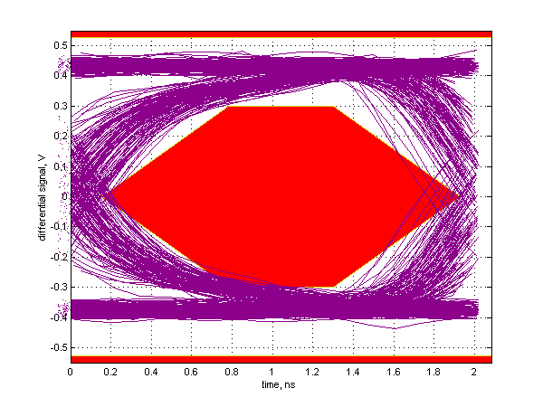

 The customer is trying USB2.0 certification and BG1.2 compliance test.
 But D+/- Eye pattern (High Speed) is NG and BG1.2 compliance test is some items was failed.
 He checked signal quality by simulation, it had no issue.
 The impedance of D+/- is 90+/-9 ohm.
 What should I check?
 If I send the schematic, pattern and BC1.2 test result, can you check these?

    The eye diagram failure is not expected, it looks like there is a lot of jitter in the signal. The BQ24392 is not a redriver, retimer so it will not improve the signa lapplied to it. How close is the signal source to the BQ24392?

    The customer has concern about layout and line impedance.
    When I send to Schismatic, layout and BG1.2 test result, can you check them?
    Ogasawara
  • Sure, accept my friend request and send to me privately if your customer does not wish to post on a public forum.
    JMMN
  • Hi JMMN,
     Thank you for your advice. Eye Pattern issue will be fixed.
