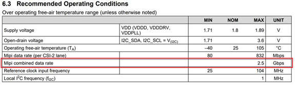

Hello Team,
 May I confirm that DS90UB935-Q1 Mipi combined data rate 2.5Gbps shows DS90UB935-Q1 input bandwidth and not its forward channel frequency?
 In synchronization mode, DS90UB935-Q1 forward channel frequency still goes with DES like 936, 954, 962, 960 external clock as shown in below Table 6.
Thank you.
