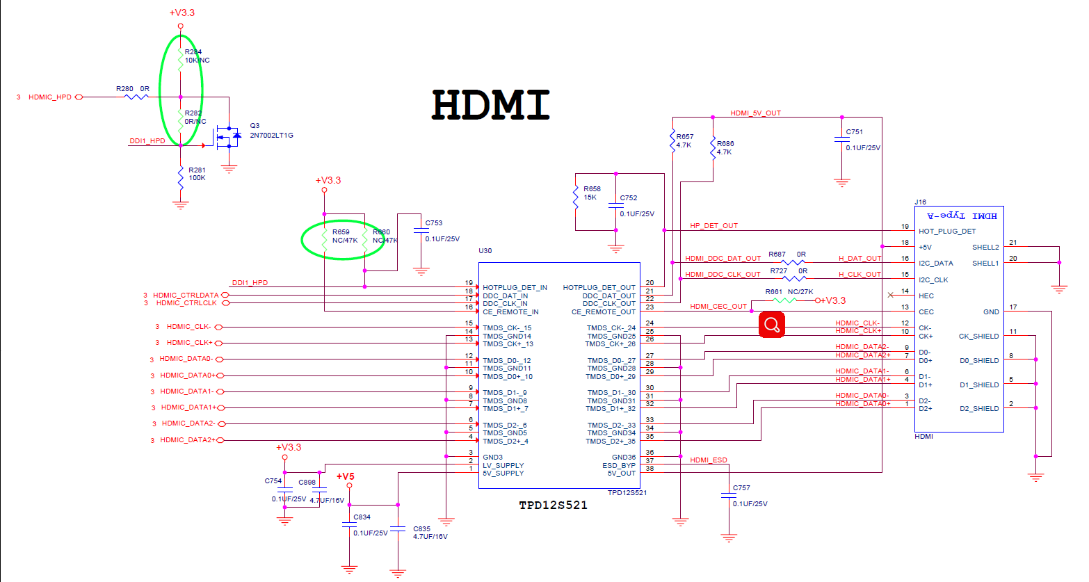

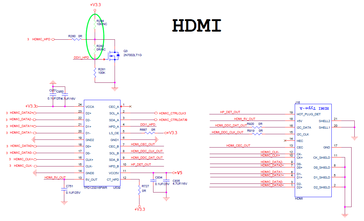

  now customer use TPD12S016 as a HDMI ESD device,  they found that HDMI signal can not transfer to HDMI connector ,then the screen unable display ; but when they use TPD12S521 as HMDI ESD device , the HDMI signal can transfer to HDMI connector, and the screen can display ; we doubt the drive ability of TPD12S016 is not enough . the schematic of HDMI show:
can your guys help us to resolve the problem? thanks very much!
