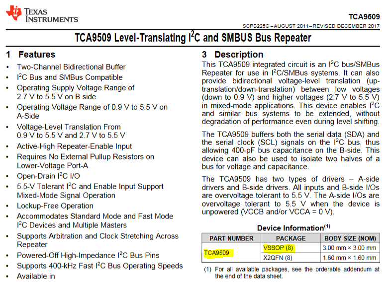

    One thing we could try is to use TCA9509 as a pin to pin replacement and see if this resolves the problem (if it is related to VoL.....). The static voltage offset of TCA9509 is on the A side of the device so the slave devices won't see a large voltage on the B side. One thing about this device is that the A side requires that there are no pull up resistors on that side so you will need to depopulate them.

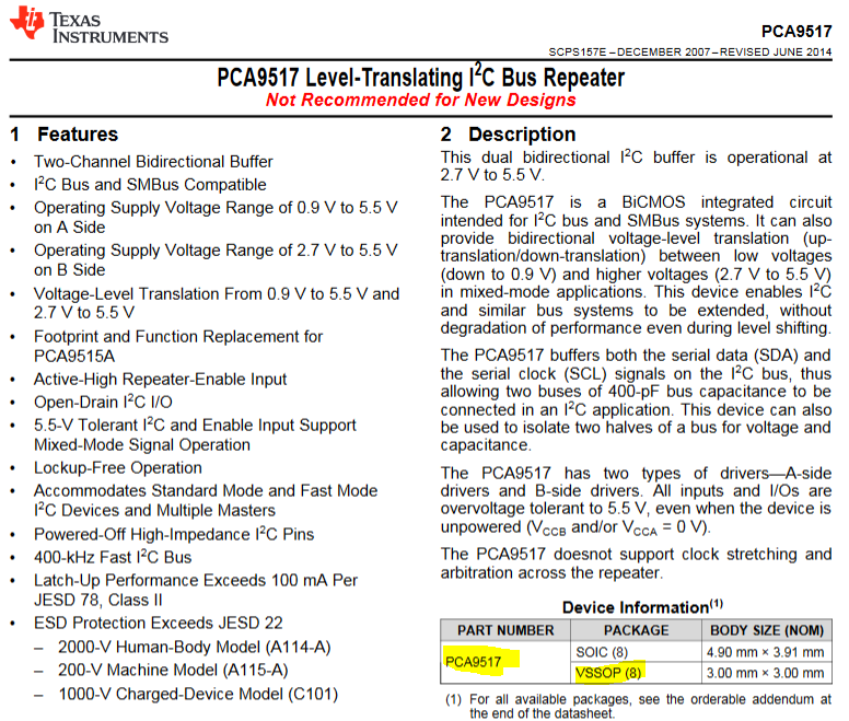

    unfortunately, they are using TSSOP package of PCA9517, Seems 9509 has no such package. any other choice?
    and below is I2C plot: blue is SCL, yeLlow is SDA.
  • Hey Vera,
    "unfortunately, they are using TSSOP package of PCA9517,"
    You mean the VSSOP?
    Because our TCA9509 also comes in the VSSOP package:
    We should be able to replace the two fairly easily.
    From your waveform I can see that the slave is NACKing but I can also see that it looks like PCA9517 isn't doing anything wrong.
    Are you able to tell me what the slave NACKing is? (device #/datasheet?) I would like to check to see if ~600mV offset is acceptable for it. It may be that VoL of the buffer is too large for it to recognize the signal is low.
