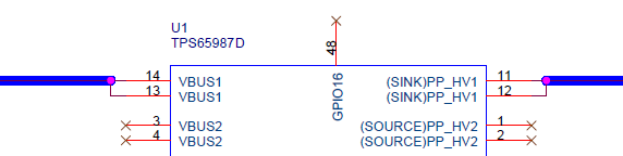

I'm making a sink only device. I use VBUS1 and PP_HV1. Can I float extraneous VBUS2 and PP_HV2 like the attached circuit?

It is recommended to short VBUS1 and VBUS2 pins together, even if you are not using one of the power paths.
However, the unused PPHV pins can be grounded.
