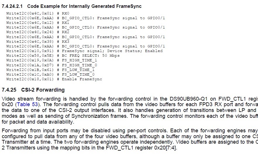

I have a problem about Internally Generated frame sync,
I follow the example from datasheet to set the DS90UB960 and DS90UB953, as below.
but I cannot capture any images from deserializer (DS90UB960).
I found out the MIPI-CSI2 CLK (output from deserializer) is too small around 32MHz, but the correct value should be 200MHz based on DS90UB960 datasheet.
Do you have any suggestions for debug further?
