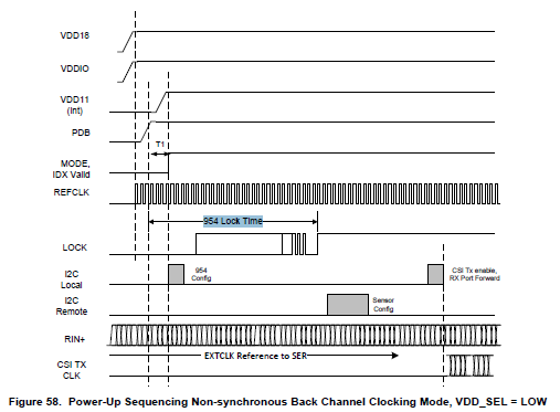

    Our customer has 2 more questions about tDDLT (Deserializer data lock time) and LOCK_STS bit.
    #1. According to the Fig57 and 58, 954 Lock Time looks line different value.
    Is "954 Lock Time" and "tDDLT" the same value?
    If yes.
    Does that mean "954 Lock Time(tDDLT)" falls below 300 ms?
    If no.
    What is "954 Lock Time"?
    #2. Please let me know the condition, that the status of the LOCK signal is reflected in bit 0 of the 0x4D register of UB954.
    I want to know about judgment function.
    For example,
    An edge of a signal is detected.
    "1" if it is HIGH for a fixed time, and "0" if it is LOW for a fixed time. etc...
    Nao

  • Hello Nao,
    "Is "954 Lock Time" and "tDDLT" the same value? "
    954 Lock Time and tDDLT are the same thing.
    "#2. Please let me know the condition, that the status of the LOCK signal is reflected in bit 0 of the 0x4D register of UB954.
    For example,
    "1" if it is HIGH for a fixed time, and "0" if it is LOW for a fixed time. etc..."
    The register will be updated every time there is a change to the LOCK status. it will not hold the register high or low for a fixed time period.
    -Michael W.
  • Hi, MIchael
    Please tell me the conditions under which the LOCK PIN status changes to hi?
    Nao
  • Hello Nao,
    Yes
    The LOCK pin will be high when ever the de-serializer is locked on to the serializer. This means that if the bit is intermittently locking and unlocking the LOCK pin will be intermittently going low and high.

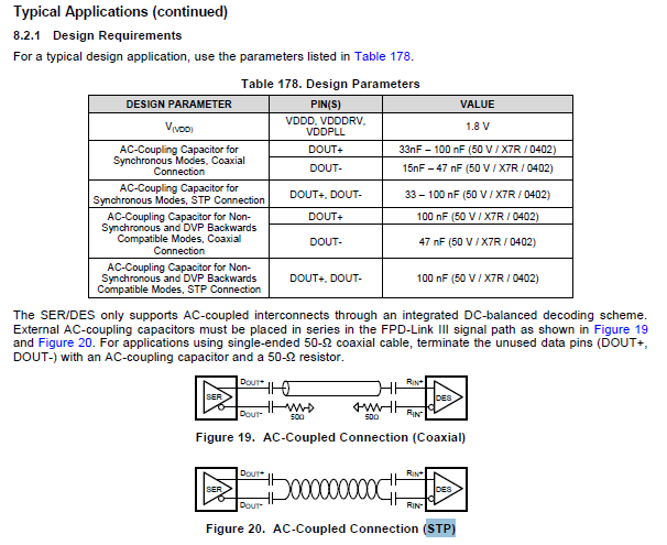

    No problem, Also please provide the capacitor values on the FPD-link lines of both systems.
    Michael W.
  • Hi Michael
    Are those capacitor values the following fig?
    Is my understanding right?
    ex) UB953 EVM
    ex) UB954 EVM
    Of course, I understand that we need our customer conditions of the using STP cable.
    Nao
  • Hi Michael
    Do you want to check this?
    Nao
  • Hi Nao,
    Yes, those are the capacitor values that I would like to check. Are both of your applications in Synchronous or in Non-Synchronous mode?
    Michael W.

    My and our customer's AI list is here.
    1. Checking LOCK pin status for the checking FPD-Link signal quality.
    - Our customer is checking the LOCK pin on the 954 now...
    2. Send to you the customer's schematics, if I get it and accept our customer to send it you.
    3. Checking customer system conditions.
    - Checking the capacitor values on the FPD-Link line.
    - Using Synchronous or Non-Synchronous mode?
    anythis else?
    let me know, if you need more information.
    Nao
