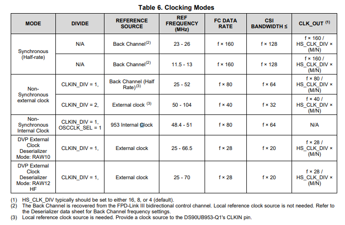

we are testing the the DS90UB953.
Is the transmission frequency via the FPD Link III transmission path dependent on the CSI-2 input?
For the application we feed 2 CSI-2 lanes with a CLK rate of 400MHz.
The goal is to achieve the lowest possible data rate on the FPD III transmission path.
Which clocking mode is better for the application - Synchronous Mode or Non - Synchronous external clock?
Thanks for the feedback,
