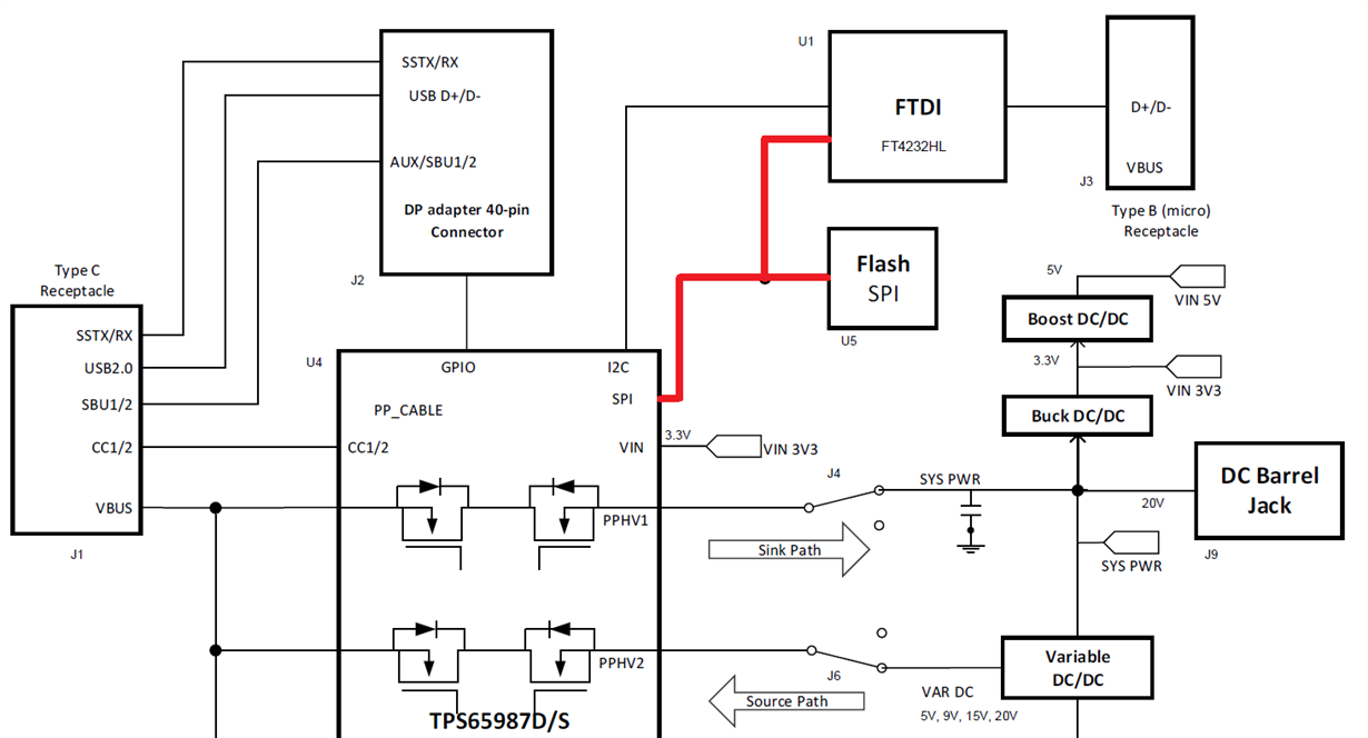

In the TPS65987-90EVM, which is the first reference, two SPI masters dominate one slave SPI Flash. The TPS65987D and the FTDI.
How they access the SPI flash while the other master alive?

Hi Jeong,
The SPI Master will toggle the SPI Chip Select line when they need to communicate to the SPI Flash.
